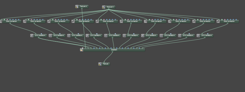

Been trying to create a procedural texture using a combination of this script and OSL textures found on this forum.
Here is my take so far. Would anyone be so kind to modify the script so everything is sourced from one texture and it takes in an arbitrary Input node instead of the randomize color input node i will the upload my orbx file here also

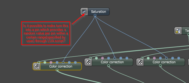

I think generally, random variations in hue or brightness are much easier to implement entirely in OSL. For the hue, see
For instance, to randomize the hue and saturation of a texture:
You can add parameters to this shader as needed.
The cell noise in this shader will supply a different random value depending on the value connected to the
and change the test in the mortar map to

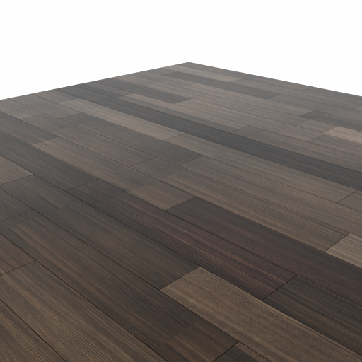

So that's the material with the above modifications: Another tip, you can slightly blur the displacement by using the filter type and filter size inputs, this can improve the appearance of the edges of the tiles.
