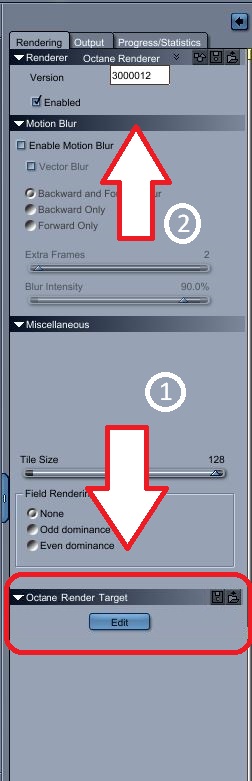

It would be great to have it available as shown in the mockup, better in position 2 than in position 1 but either works since it would launch the pop-out anyway.
Render room Octane target add-in

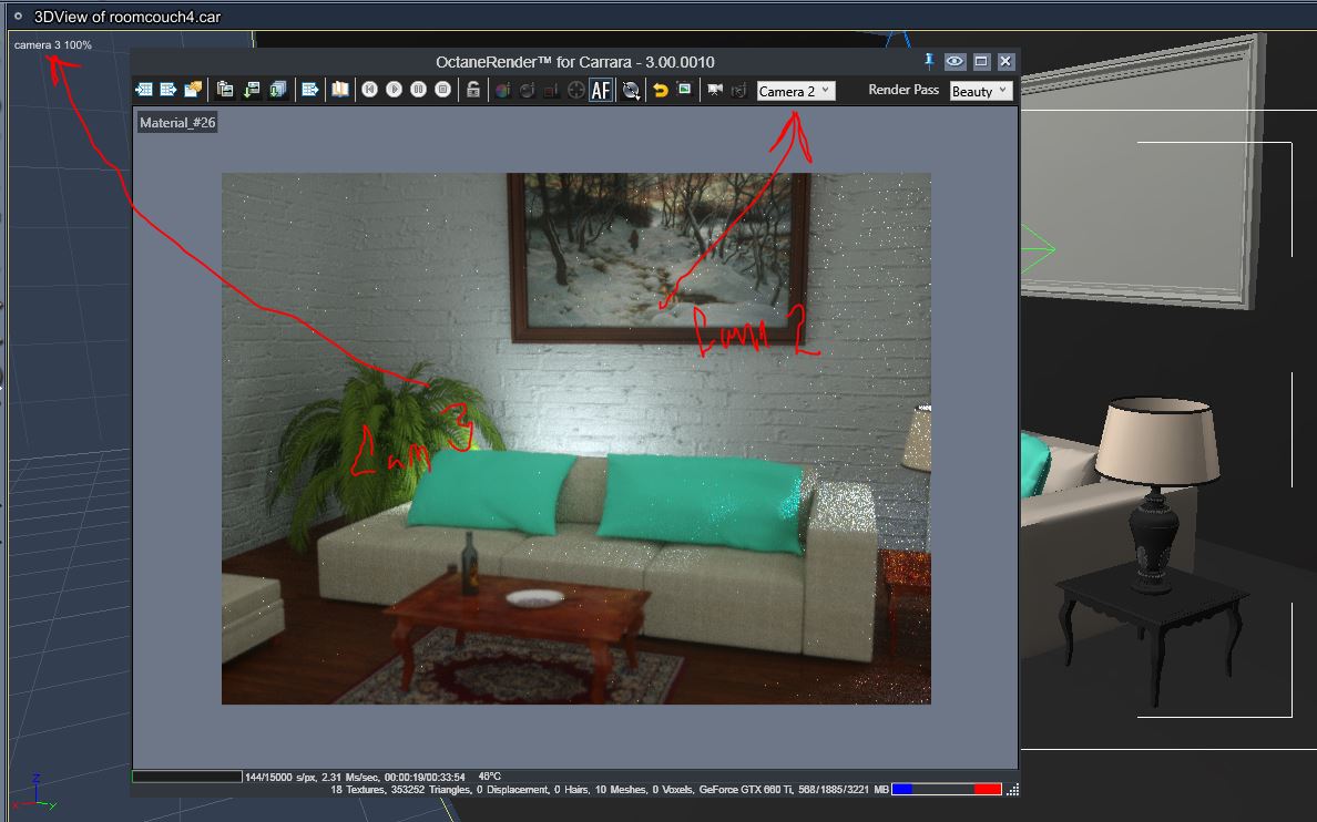

So the process should be, while working in the assembly room use CTRL+SHIFT+R to open the Octane viewport to do test renders and adjust scene as needed. Once you determine that the scene is to your liking go to the render room and switch from Photorealistic to Octane Render from the dropdown make final adjustments with the soon to be added option :twisted: render final scene.
UPDATE:
Interesting that CTRL+SHIFT+R brings up the camera that is set in the Render room and not the one used in the Assembly room. In my test scene I have 3 cameras, I set Render room to camera 3 and return to Assembly room. Press render sequence and the Octane default camera is the one specified in the Render room and not my current view port. This is good to know.
