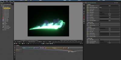

Now this Juanjo already showed me in Houdini, works exactly the same ;)
This was the flame exported as an ORBX. The imported ORBX into Standalone had Kernel 'Max Samples' = 99,999, it should have been 1,000.
Flame color in honor of the Constructicons...or Joker...

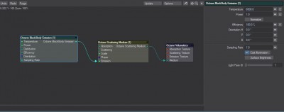

The key to use the blackbody emission node is play with the emission scale parameter. The blackbody emission node gets the color temperature from the emission volume data, so if in the simulation the emission voxels data have a range from 0..1, you must scale it by something like 4500 to get a nice fire temperature color. Also remember to disable the "normalize" option in the blackbody emission node. You can also play with the absorption and scattering parameters in the scattering node to get the smoke effect.
You can use any TFD or OpenVDB grid in any Octane volumetrics channel, in this case you can use the "burn" grid to drive the emission channel without problems.

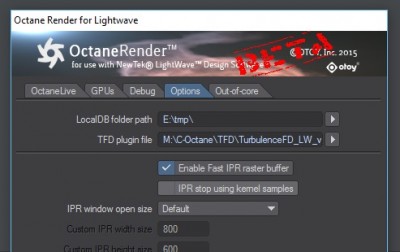

Notiusweb wrote: (2) It looked like my Kernel was set to 1,000 max samples (I believe is default), but the IPR appears to be rendering past 1,000, up to 99,999. Might I need to do something with another setting?
Notiusweb wrote: This was the flame exported as an ORBX. The imported ORBX into Standalone had Kernel 'Max Samples' = 99,999, it should have been 1,000.
By default the IPR is going to refine the image continuously, but if you want to stop the render after reach the kernel samples, you have an option in the plugin options panel to enable this feature. Also with this option enabled, you should get the right samples value exporting the .orbx file.
