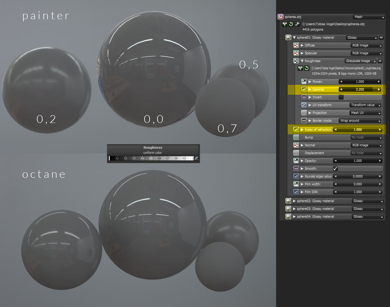

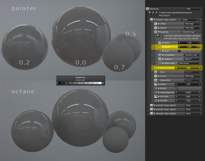

400$ for pro version :(
With SP you can work with metalness and at the end for the export, you choose octane profile and it is done!
Just compensate the gamma in spec and roughness with 1.45 instead of 2.2 and IOR with 1.

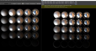

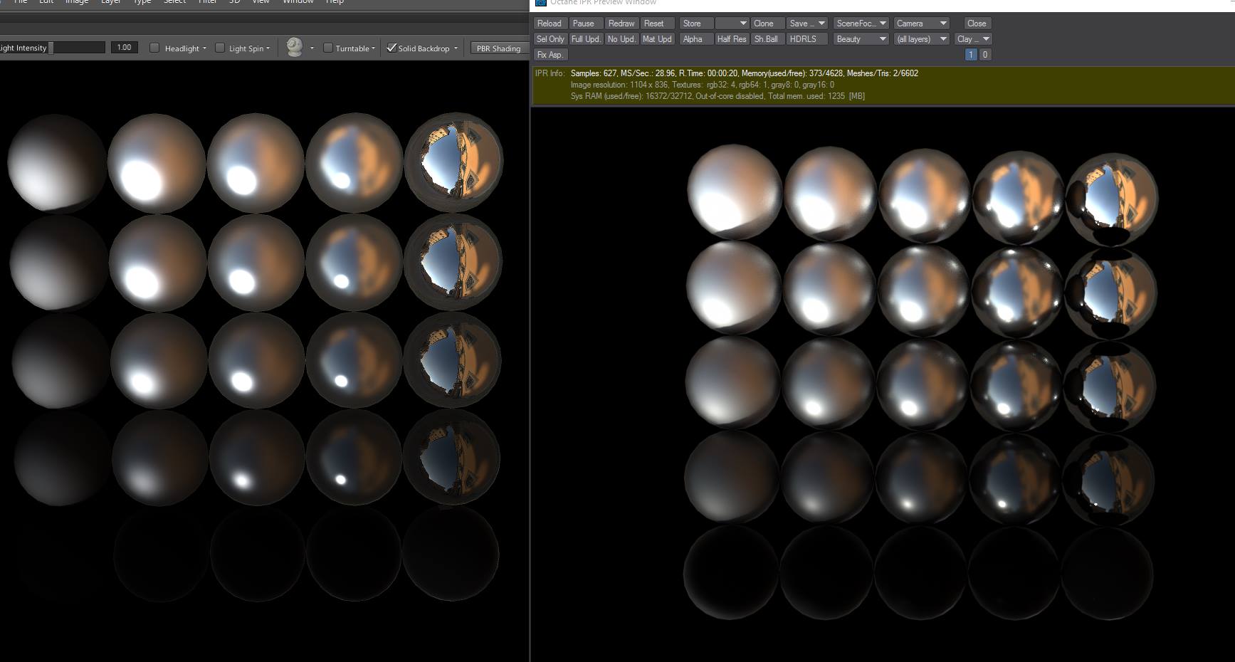

Sorry I just noticed this thread was talking about C4D. I'm using Lightwave, but I don't imagine it should make much difference. I use the Octane (sRGB) exporter. plug maps into a glossy, all at 2.2 except the roughness which I set to 1. For non metals, i use in index of 1 and it should look right. For metals, I tweak the index way up. If I have a mix of both, I use two glossy nodes with different indexes, and mix them using either a high contrast version of the specular, or export a metalness map (after adding it to the project obfioulsy) and use that to mix. Results are shown here between quixel and Octane IPR.
And something I textured in Quixel, rendered this way in Octane.
