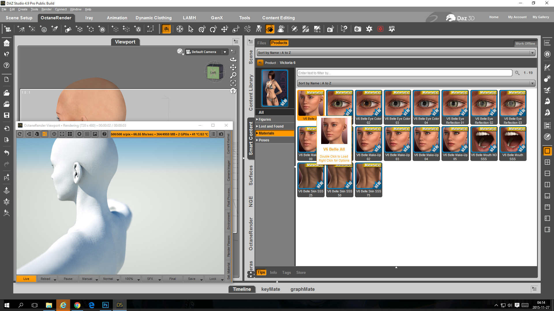

Steps to create a test scene for a figure with displacement, bump and normal maps applied at the same time:
- Load Victoria 6
- Apply the "V6 Belle All" material preset on V6

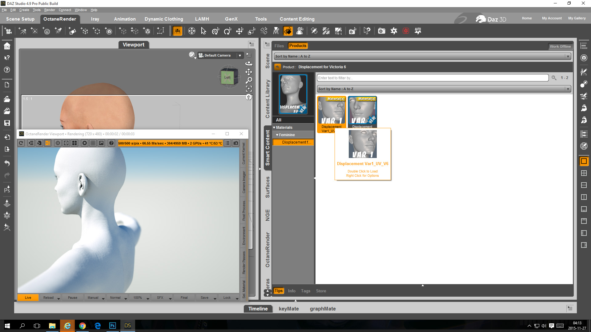

- Apply "Displacement Var1_UV_V6" material preset on V6

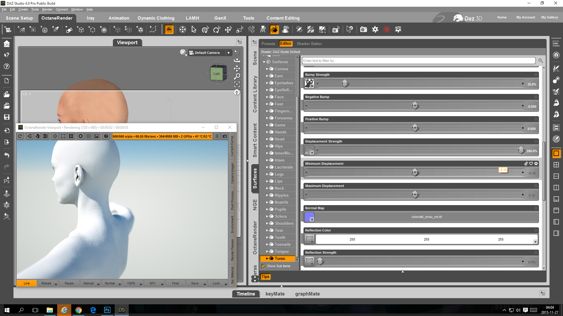

- Check the DAZ Studio surface tab and examine the V6 torso surface zone to check if displacement, bump and normal maps are all added

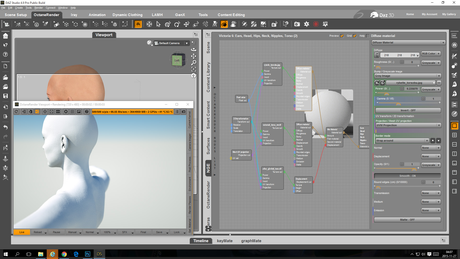

- Trigger OcDS Material Auto Conversion either manually or by opening the OcDS viewport
Currently you can observe another issue:
- For some reasons in some figure material setups the diffuse maps are not picked up with auto conversion.
I have not yet figured out why that is. It seems to happen both in 3Delight and Iray setups (Michael 7 Iray for example.)

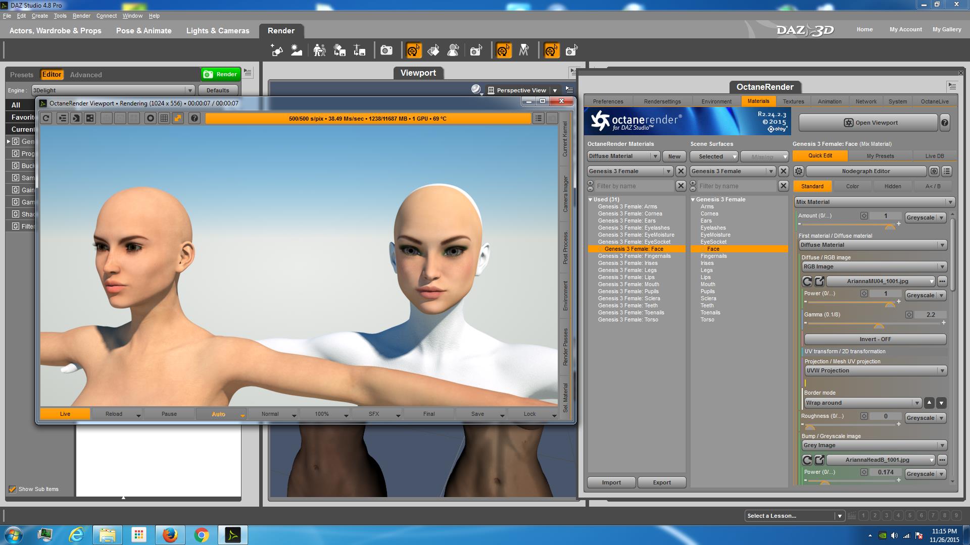

Notiusweb
Posts: 1285
Post by sixb0nes » Fri Nov 27, 2015 2:58 am

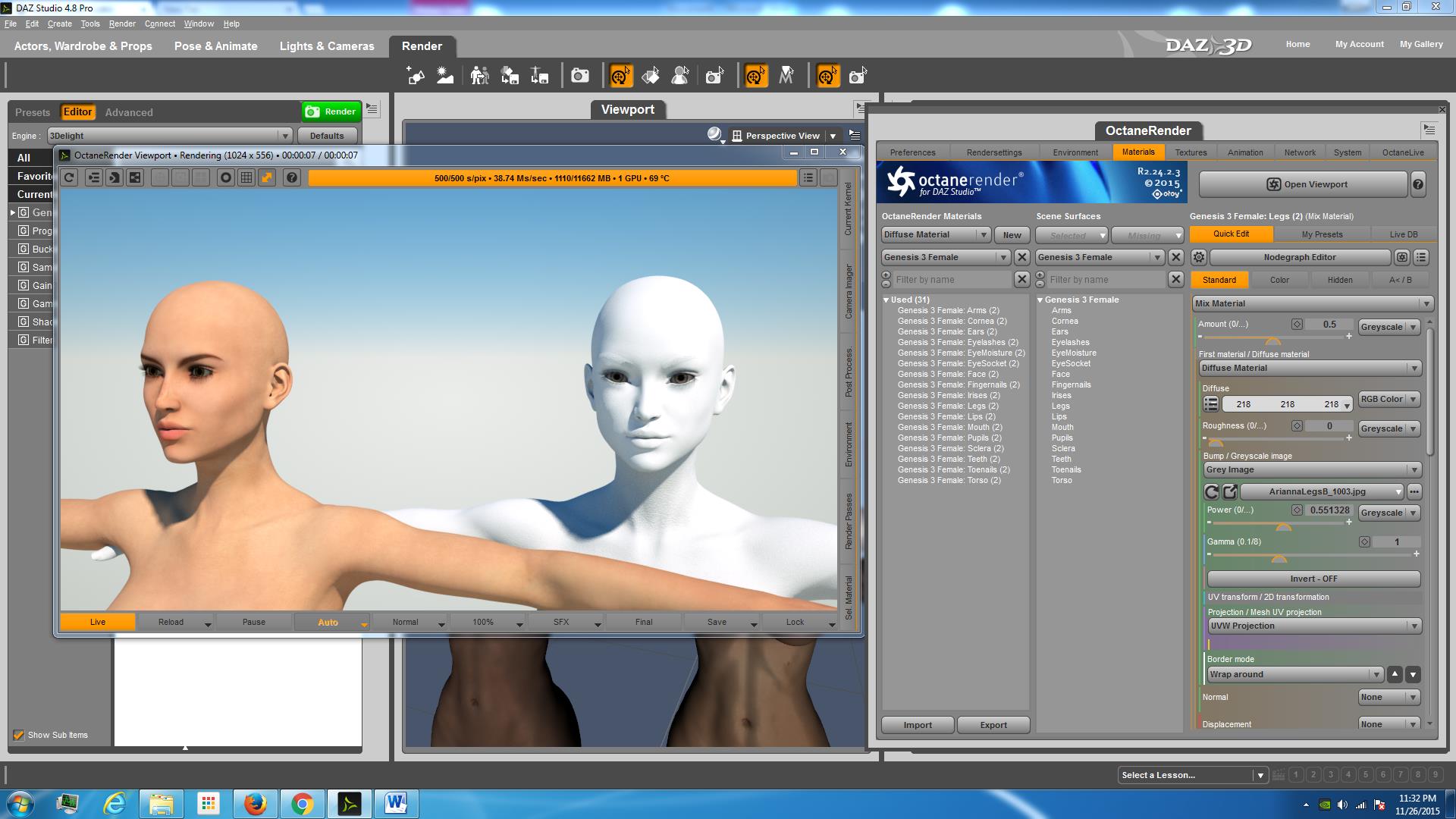

Initial reaction is quite positive. Most of my default Iray G3F conversions now come across with much better results. Here is a quick video exploring one that doesn't.
Issue confirmed on my machine too, same character (Arianna G3F) imports all white.
I am able to 'fix' by
(1) changing, in OcDS, Diffuse Material from 'RGB Color' (white) to 'RGB Image',
(2) loading an image,
(3) then setting the master 'Amount' from defaulted 0.5 to 1.0
Interesting to note, Arianna (R) comes over as a Mixed Material. The Adaline (L) comes over as Diffuse.
Here is a screenshot of issue and then me having used the above workaround to fix face and lips:
Diffuse Material as 'RGB Color' (white)
Diffuse Material now 'RGB Image'....She looks like a white Teletubby

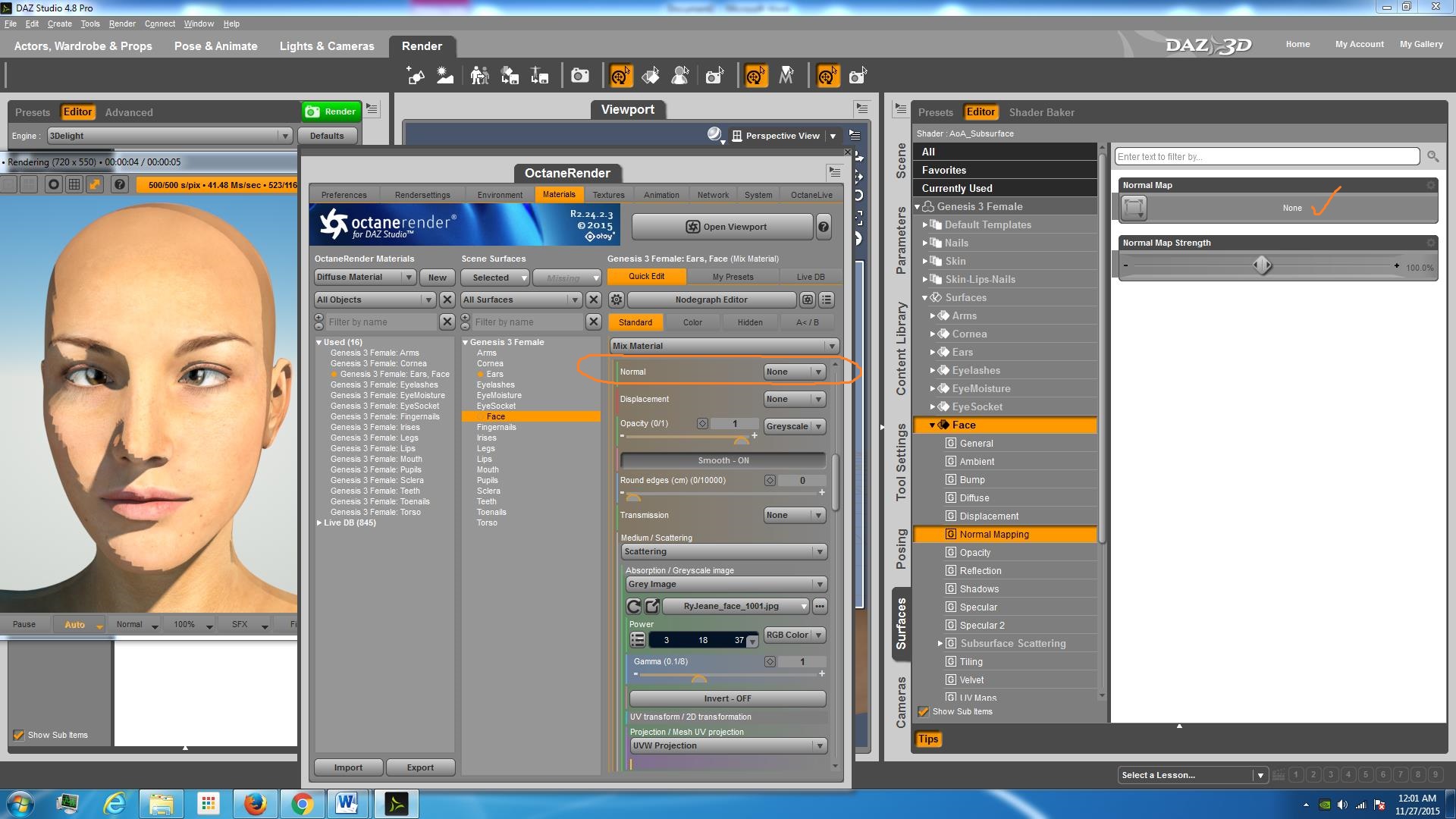

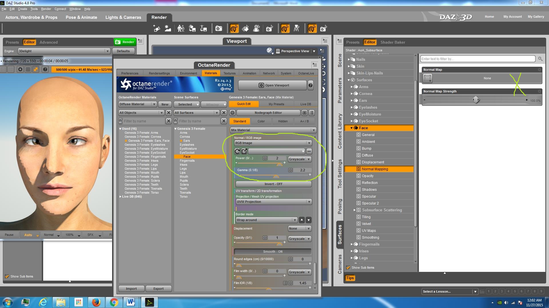

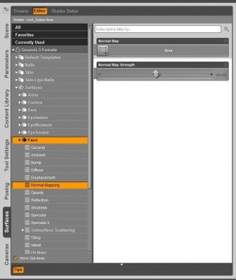

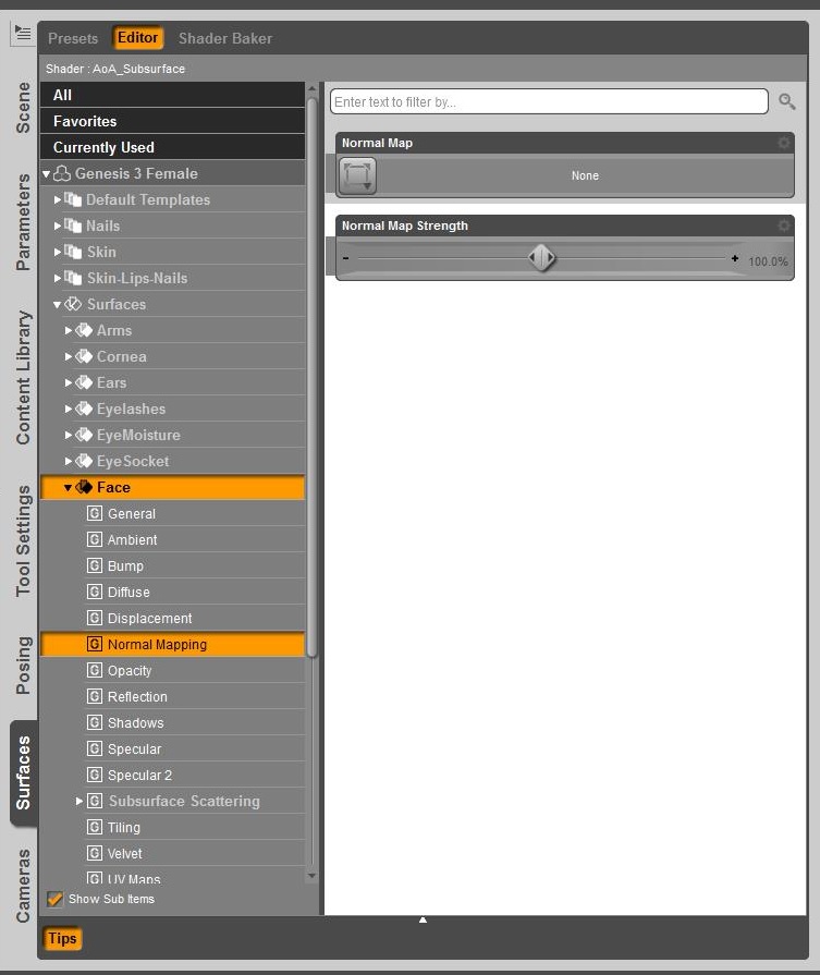

Paul, I think this will cut straight to description of the SSS-mat bug and justification for fix:
a- we load the default Genesis 3 Female from the free Genesis 3 Female Starter Essentials. It by default loads with a SSS-mat.
b- we select the G3F's 'Face' in the Surfaces Pane in DAZ
c- we select Normal Mapping to highlight just that category
d- It shows 2 entries: (1) Normal Map = None, (2) Normal Map Strength = 100%
DAZ - G3F Face Normal Mapping in Surfaces Pane
e- Now, when we render to OcDS, and look at the G3F Face material, it is a mixed Material with 2 instances of 'Normal' (I have them shown right beneath 'Mixed Materials' on OcDS)
(1) Normal #1 = None (fine, what we expected)
OcDS - G3F Face Normal #1 (Matches with DAZ, Good)
(2) Normal #2 = RGB Image (does not correspond to the DAZ), with a power of 2. And this power of 2 is what causes the Toonish Textures
OcDS - G3F Face Normal #2 (Does Not Match with DAZ, Bad, power at 2 causing the Toonish Textures)
f- Therefore, this could be justification to fix the issue as follows:
If Normal Map = "None" (on DAZ), and there is no 2nd Normal Map (on Daz), then in OcDS set both Normal #1 and Normal # 2 in Mixed Material to "None"
Mobo: 1 Titan RTX, 1 Titan Xp
