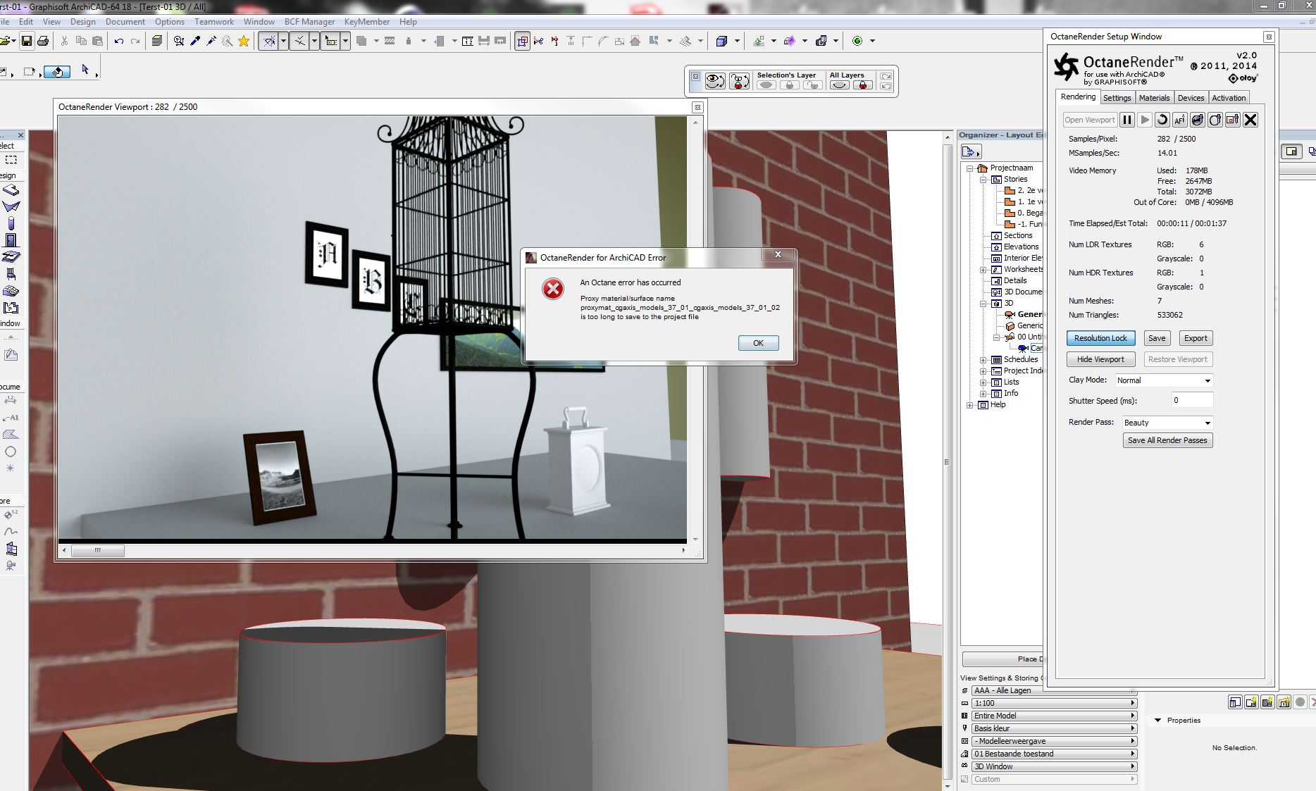

Back to texturemap name length.. I am getting this error when saving the Archicad file,
but what is my problem working with these long texture names? It does nog save them to project file, but they are showed in the render!
greetz,
Proxy material name length is still set to the long 50 char limit. I will fix this in the next release (a day or two away).
