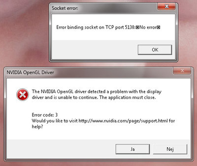

I have some crashing going on to... It seems it is scene specific. Not sure what I did to create this problem. Worked fine on earlier versions of the scene. I have a Titan card 6Gb (first edition). Blender hangs during viewport rendering for about 4 seconds before shutting down. I get these error messages (attached below). Can´t find error code 3... I first thought it was a graphics card error only, but could the TCP port have something to do with Octane server?
I reinstalled graphics drivers, but that did not help. What about Cuda drivers? I can´t find out if latest Cuda (6.5) was installed with the latest graphics driver. I know early versions of Octane demanded Cuda to be installed separately. Are you guys installing Cuda 6.5 separately or just running your latest graphics drivers?
I think I have a workaround for working on with the geometry and rendering in another scene, but it would be interesting if any one knows what this might be.

These are different errors.
TCP port error, as I wrote earlier - happens mostly due to the port is already occupied by other process. Most often it happens when you are trying to start the second instance of OctaneServer on the same machine - as the port is already used by running instance, the second start fails. This "extremely meaningful" ("no error" :lol: ) error description is returned by windows network stack, the Octane server just shows it to you unchanged.
But your second error is more interesting. Most likely it may mean that the GPU, which is used for displaying of the user interface (by OpenGL driver in this case, e.g. Blender uses OpenGL both for viewports and for user interface), is busy by some other things and does not respond for some time. So, after the timeout - the error is raised.
Most likely the GPU is used by CUDA rendering from inside of OctaneServer... This is why I always use the separate not expensive GPU for desktop only, never enabling it for CUDA rendering...

Ah, yes, the TCP message was "hiding" behind the code 3 one, and when I found it... Well... *no error* :mrgreen:
I´ll see if another graphics card will help for handling the viewport will help. Have to read a bit about how that will work.
Thanks!
