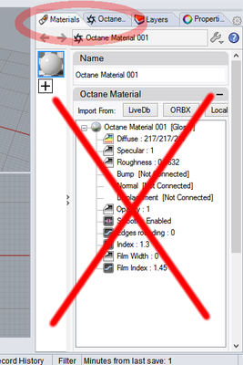

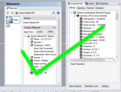

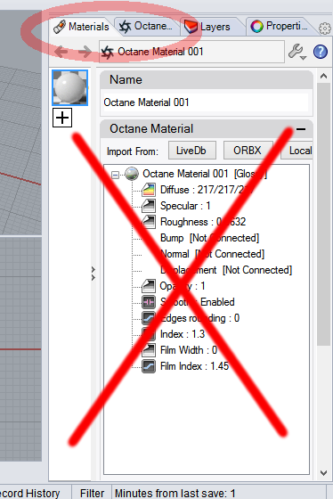

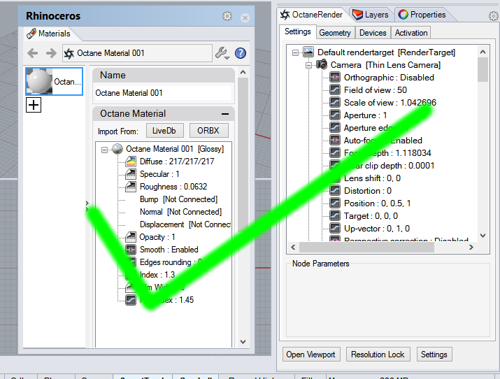

IMPORTANT PLUGIN INFO: There is a Windows/Rhino bug where if you have the Rhino Material panel docked to the Rhino UI, then when you move a slider on an Octane Material and then tab to the Octane tab, Rhino will lock up. To get around this, Undock the Rhino Material panel. McNeel will be releasing a fix for this shortly.

And a reminder about keeping the Material panel UNDOCKED until McNeel issues are fix as per the msg above.

Btw, I have materials tab docked and it works ok
But i'm very careful with it
