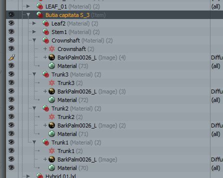

1-If you have a material grouped under a group matereal doesn't update like it's outside form it.check the image of a grouped octane material.
2-while rendering if you change mesh visibility inside modo(toggle the eye on/of) nothing changes in octane.HOWEVER, if you have meshes nested into a folder they do!
so, that means that meshes inside a group are being loaded into octane even if they're toggled of.
Cheers, will be coming back here more often now :)
