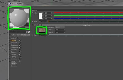

Hi Ahmet,
havn't installed a video capture prog,
but not neccessary here.
My material preview looks like this. Grey.
From time to time it is flipping between showing the texture
and grey like in the screenshot.
I have have 2 Titans .
Whatelse could this cause?
Like I said, I haven't had this problem with 1.21 and earlier.
regards
Mike

Hi Aoktar,
please see attached video!
Capture.mp4
(1.95 MiB) Downloaded 3785 times
regards
Mike
Posts: 16068
Location: Türkiye
mike, I see but couldn't produce this problem on my computers. i can dig if I have.
for sdk 1.37 text, if you see a text as 1.50.003 in console and plugin hasn't any crashes it should be sdk 1.50.

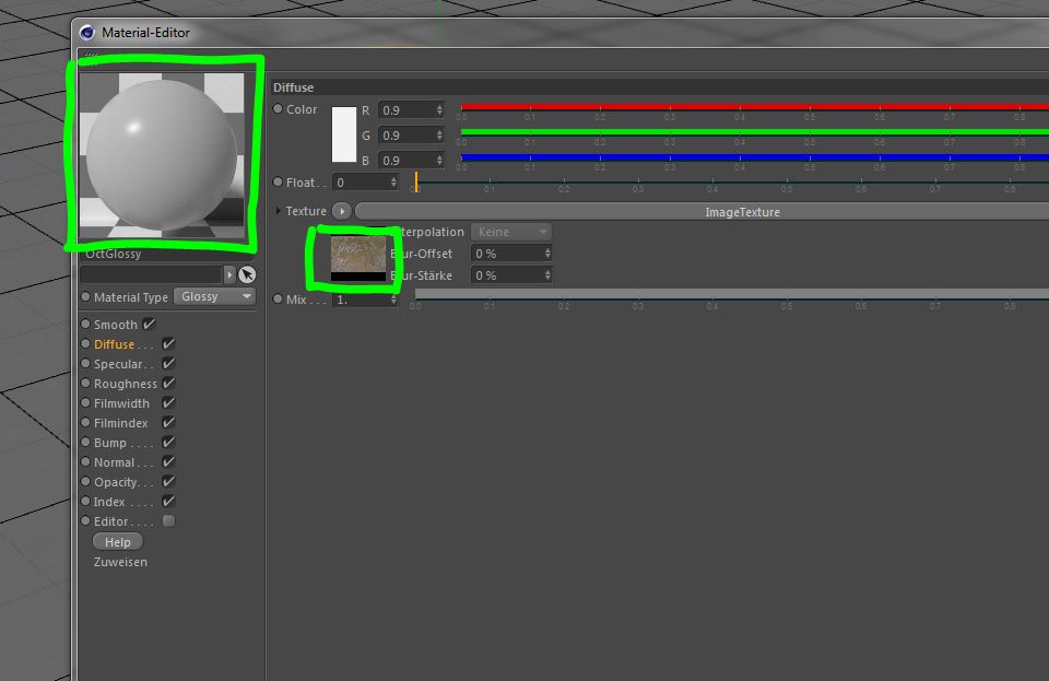

Hi
I am having the same issue with 1.50... versions. Material shows up grey in preview.
Also Dialog says SDK 137.
No problems in prior versions 121.

Posts: 16068
Location: Türkiye
Uhmmgg, Big sorry to all. Log file of Oleg is showing that a mistake on compilation. Plugin was compiled with 1.37, i'll fix asap.
So 1.37 texts was correct and this is reason of disappearing textures.
