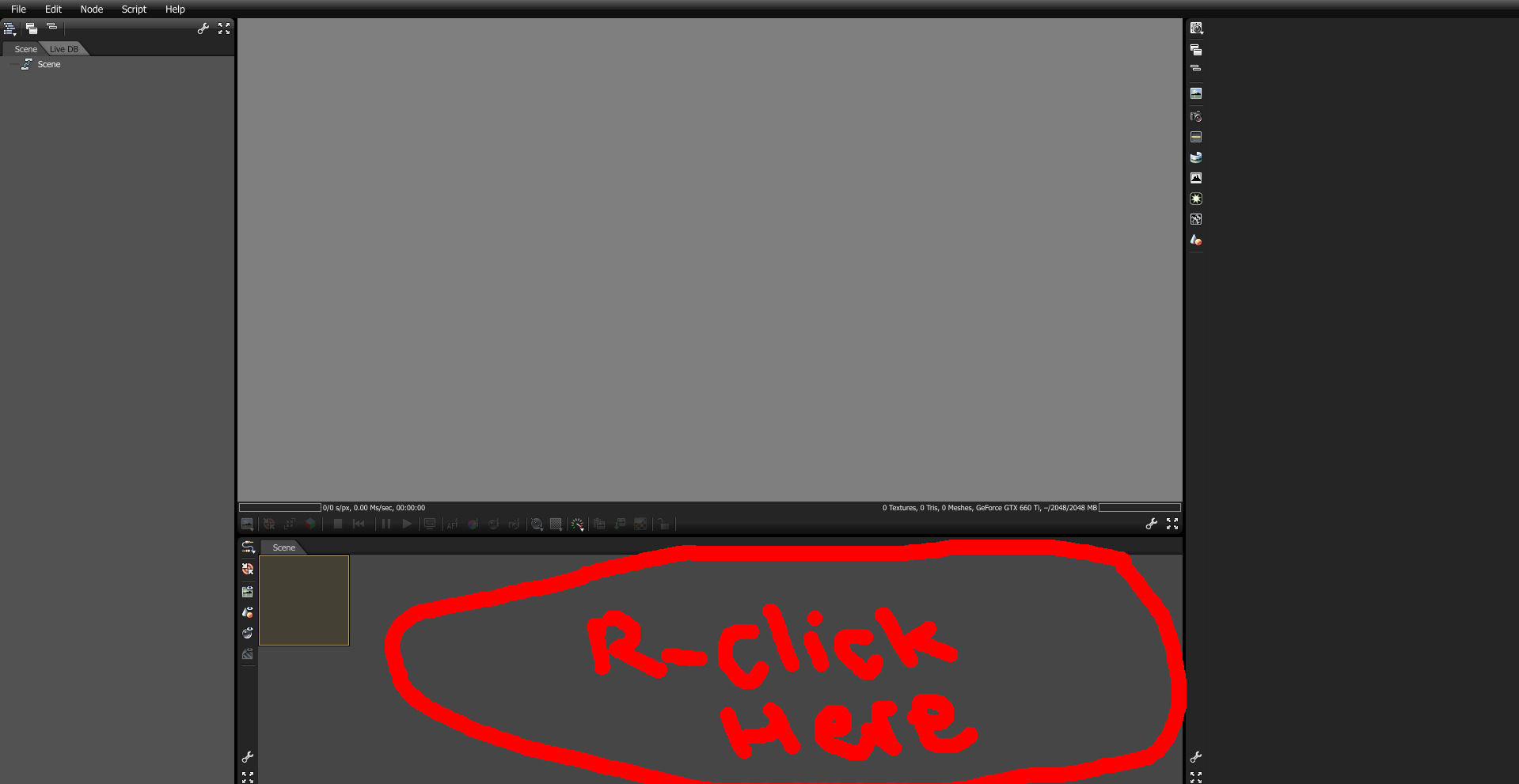

orion_uk wrote:
voon wrote:Erm, silly noob question: can the RCs not import OBJ files?
Right click & choose GEOMETRY/MESH import rather than SCENE (scene is for Amlebic import) and you will see that you still can :D
Uhm, sorry if I sound daft, but ... right click where?

voon wrote:
Right click in red area :)

voon
Posts: 527
Joined: Tue Dec 17, 2013 6:37 pm
Ah right, found it :) thank you.
