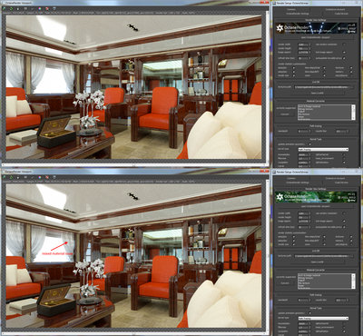

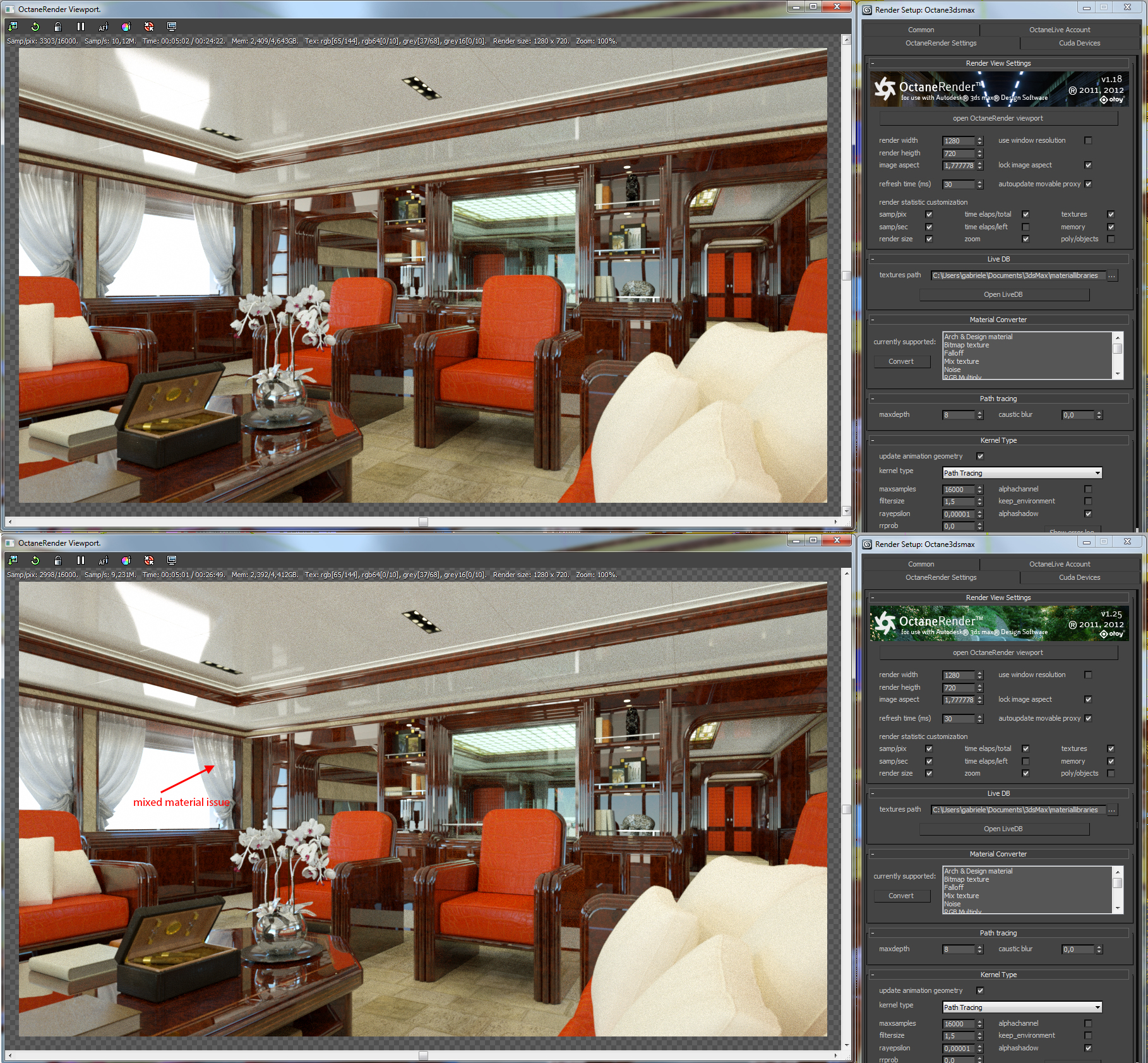

I confirm that the 1.25 release is slight slower than the 1.18 (1.20)
Also the material on curtains have an issue:
The material is a mix between diffuse and glossy. Fall off is on the diffuse slots for both mats. On the glossy mat the reflection is generated by a marble procedural.
regards

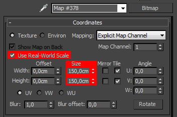

in the material conversion process (scanline standard material => Octane material), is there a way to convert real world scale to something understandable for octane?
real world scale.jpg (80.13 KiB) Viewed 4598 times
3dsmax plugin can do only the things Octane can.
