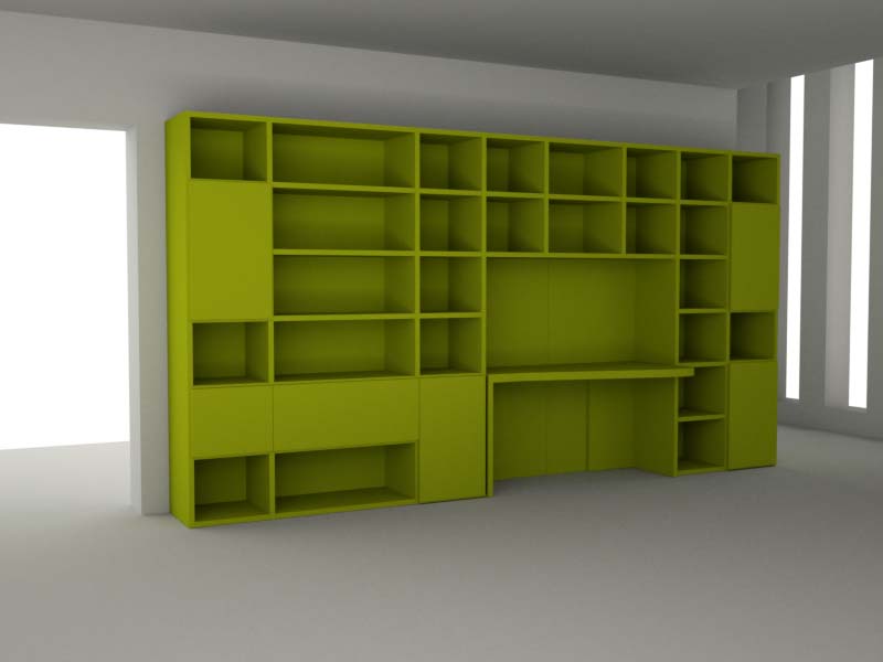

there is a problem with object layer..I use it to overlap parts of the scene in post production (Photoshop) in order to avoid clipping on a completely rendered image. The pieces that make up the final image but never correspond to the same fully rendered. These parties have in fact along the edges of the dark pixels that really should not be there. Here is a imagine to understand better ..
Orgininal image completely rendered
Union of the parts separately rendered
I hope I have explained the problem .. if you have any questions I'm here ..
Ps: it isn't a post production problem. :mrgreen:

Area D wrote:Hi,
This is a normal artifact from antialiasing. You can decrease it by setting filter size to the minimum and rendering at a higher resolution but it will is always there.
What happens at the edges is that you get pixels contain a mix between two objects. If you render both object every sample has either one of the objects and you get a normal fully opaque pixel. If you render separately you get something like 50% transparency in the image of the first object, and 50% transparency in the image of the second object. If you composite these image the result is a pixel with 25% transparency.
Or instead of transparency a part of one of the objects which is shadowed by the other object may show through, causing a dark edge.
Roeland

roeland wrote: If you render both object every sample has either one of the objects and you get a normal fully opaque pixel. If you render separately you get something like 50% transparency in the image of the first object, and 50% transparency in the image of the second object. If you composite these image the result is a pixel with 25% transparency.
Roeland
Why this?
I thought that by stacking two images 50% trasparency obtained one 100% opaque.. :roll:
Intel Core i7 950\Zotac ION 512 mb, 1 Gainward 780 ti 3 gb\ 12 gb\ W7
roeland
Posts: 1823
No, that's wrong. The bottom layer has 50% opacity, so you see 50% bottom layer and 50% background. If you add the top layer, also 50% transparency, then you see 50% top layer, and 50% of what's below, i.e. 25% bottom layer and 25% background.
Roeland
