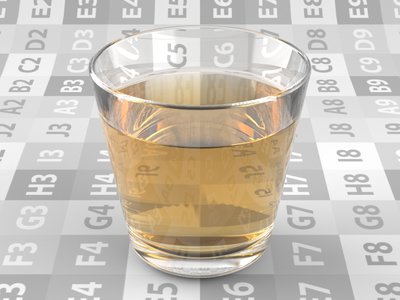

IOR < 1 is great, now we have a the ability to render interfaces, Thanks ;)
