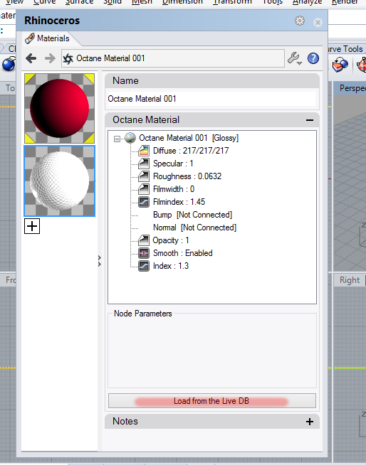

I need to update the manual for 1.29, so my apologies that this was not documented correctly. The LiveDb materials can be accessed in the Rhin plugin by going into the Material panel, creating a new Octane material, and at the bottom of the "Octane Material" panel click the "Load from the Live DB" button to load a Live Db material into this Octane material.
