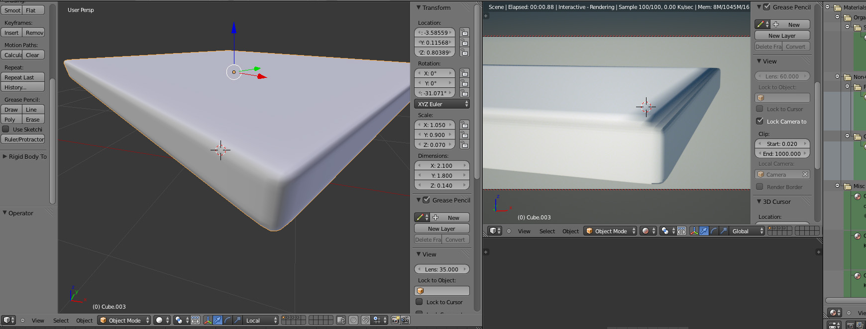

Great work on this plugin JimStar, I only noticed that smooth and scaled objects are messed up. The problem can be fixed when applying scale but could that be done automatically when the mesh data is transferred to octane server? I've attached a screenshot of the problem.
Also all objects are always rendering with smoothed normals event the flat shaded objects and the way to fix this is to turn off smooth in material or to add EdgeSplit modifier but can't you just detect that and display smooth normals if they are smooth in Blender viewport or flat if they are flat?

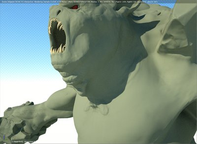

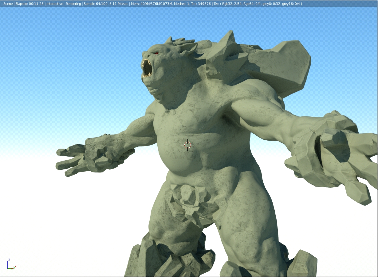

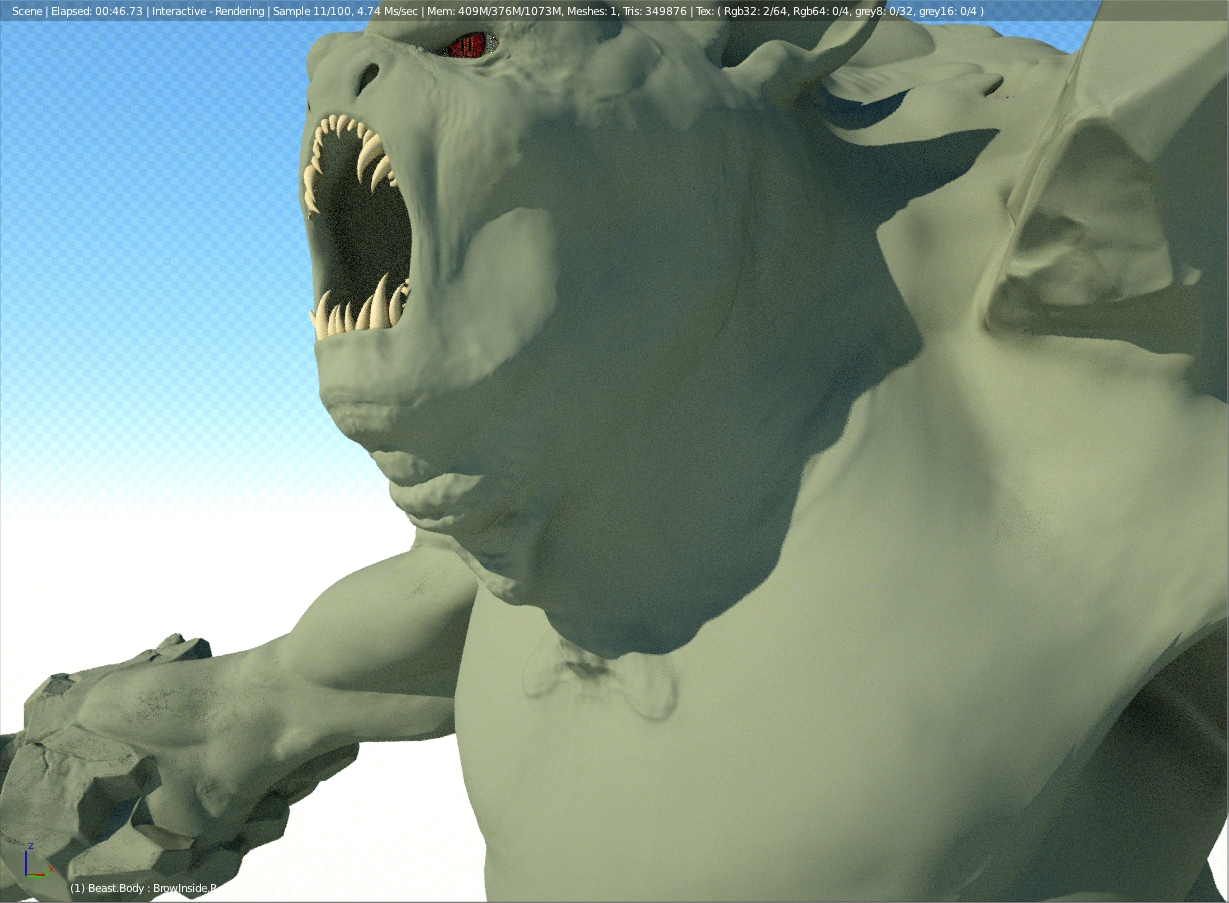

Hi!
I'm having a problem here with complex mesh object: if the camera is close to the object's surface, it renders normally, but if I move the camera away the surface becomes... wacky (see the screenshot).

you can try to increase the ray epsilon valueaLeXXtoR wrote:Hi!
(render tab > octane kernel)
