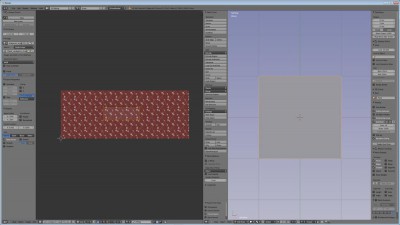

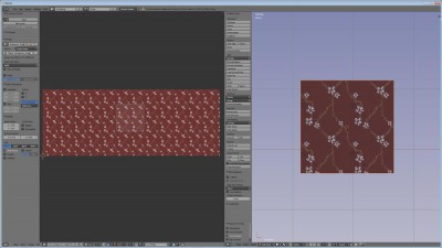

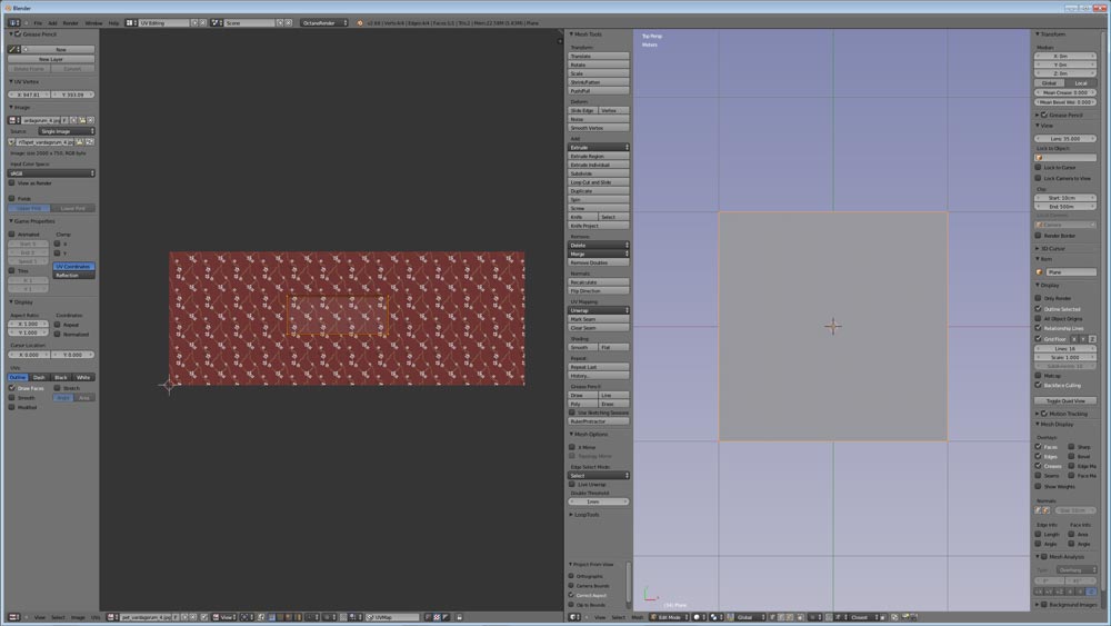

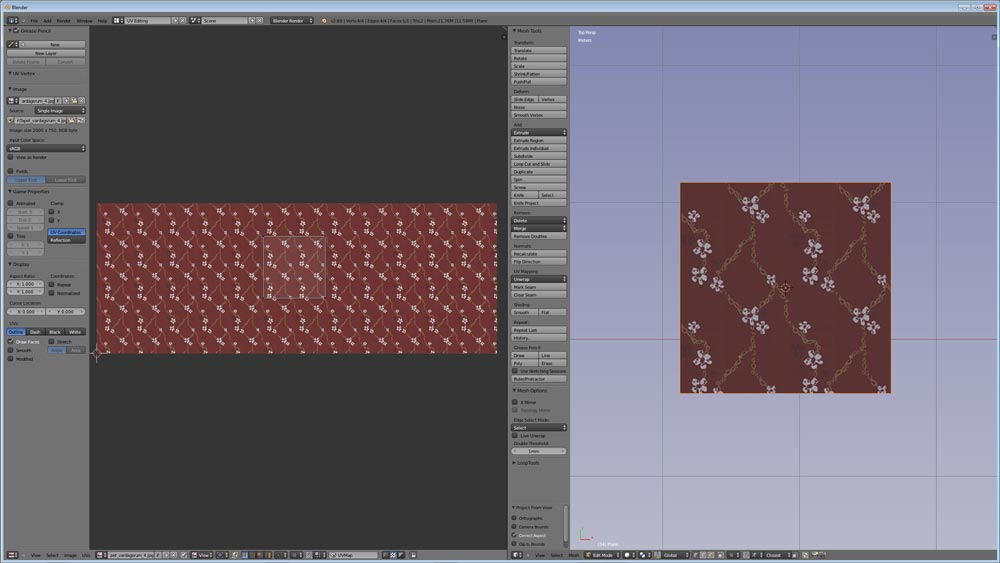

Hello!
I have a bit of a strange behaviour that I have narrowed down a bit since I posted in the 1.1 beta section.
When I have a non square image loaded when UV-unwrapping, the projection of the square plane takes the exact form of the texture. This is true for all textures that are non square.
Also, I can´t figure out how to show the texture from the UV-mapping process in regular shading mode as I can in Blender. Pretty handy thing since I tend to use UV-grid textures when I UV-unwrap. This does not work for me in material mode either where you have to do a node based setup in order to see a texture.
Is this a bug or should I be doing something different in BlenderOctane?
First image is from BlenderOctane with a non square projection, and the second from Blender with a correct projection.
Thanks!
::mb
Is this the right place to post questions like this? In the beta 1.1 there where a bunch of bug reports, but in 1.2 it´s mostly about getting the plugin running. Am I the only one facing this shader and projection issue?
Non square projection of a square plane
Square projection from a square plane (as it should be)
