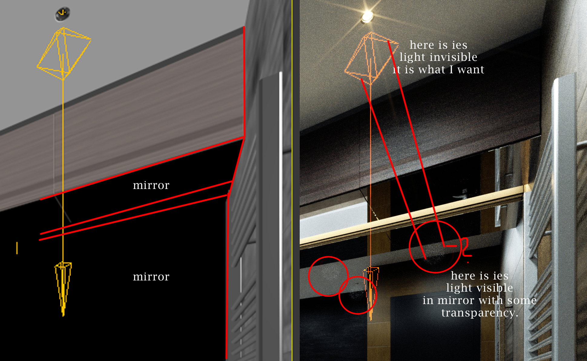

Karba wrote:This is normal.jan kudelasek wrote:Hi Karba,
I have noticed that invisible ies lights are visible in mirror reflections.
Could you test it please?
Jan
Sorry, but I don´t understand you .
Did you look image good? There are bubbles with a lot of small dots.
I don´t want these ies lights visible anywhere, it is not possible?
thanks
W7 / Quad Core Xeon E5405 / 24G / Asus ENGTX 480, 580 / http://www.allcity.cz / https://www.facebook.com/pages/Allcity/ ... e=bookmark
That is impossible to hide light source in reflection completely because even mirror has very small roughness and produces hotspots. You can try to reduce the size of your ies and place closer to real light position.jan kudelasek wrote:Karba wrote:This is normal.jan kudelasek wrote:Hi Karba,
Jan
thanks

image for better understanding

ok. I will try it. thank you.
