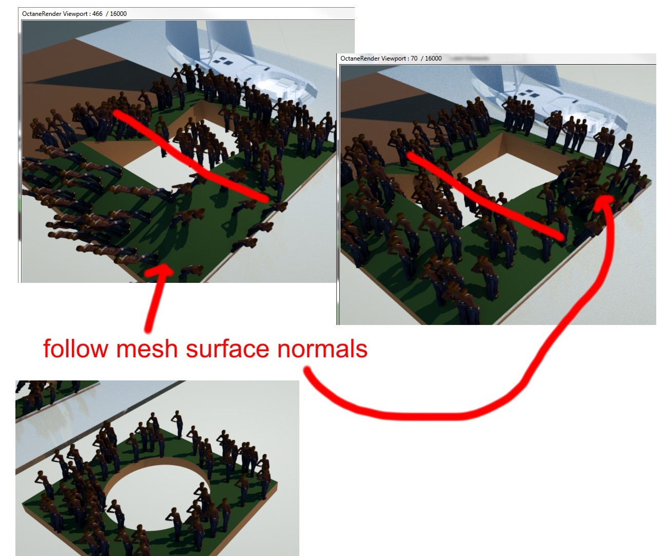

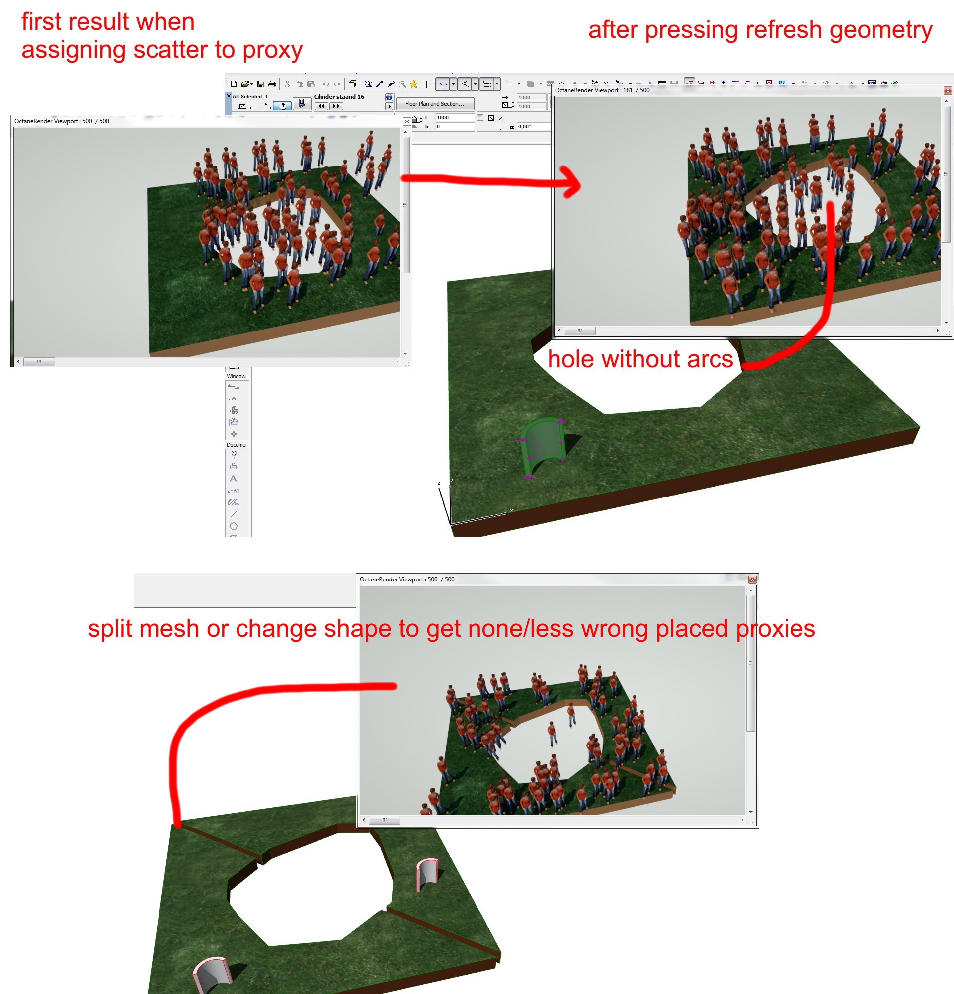

face_off wrote:I have further investigated the scattering on meshes with holes, and for the moment there are limitations in the plugin's ability to accurately detect holes, specially with curved edges. I have improved "hole detection" in the next release, but it is still not perfect. So if you are scattering onto a mesh with holes, keep the holes "simple" and do not used arc edges for the hole.
Hi Paul,
I am trying to find out more how and when proxies are placed in the holes unwanted.
I attached the image just as information, not as a remark, coz' I know at this point it is an issue to pay attention to.
I noticed another thing: when assigning scattering the proxies seem to be placed strangely, but afte updating geometry they are not... I encountered this a few times, so now I always update the geometry to see what it does.
greetings, Jeroen
Fixed in the next version.
Hi Paul,
I investigated the scattering on meshes with holes some more and I found out that when using the
"follow mesh surface normals"it always seems to go right! Even in with circular holes.
Maybe this helps you in fixing this issue?
And for now it always usable except when needing object to be scattered on meshes with variable heights and wanting it not to follow the mesh surface normals.
greets, Jeroen
