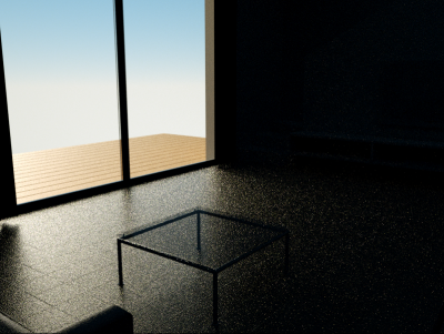

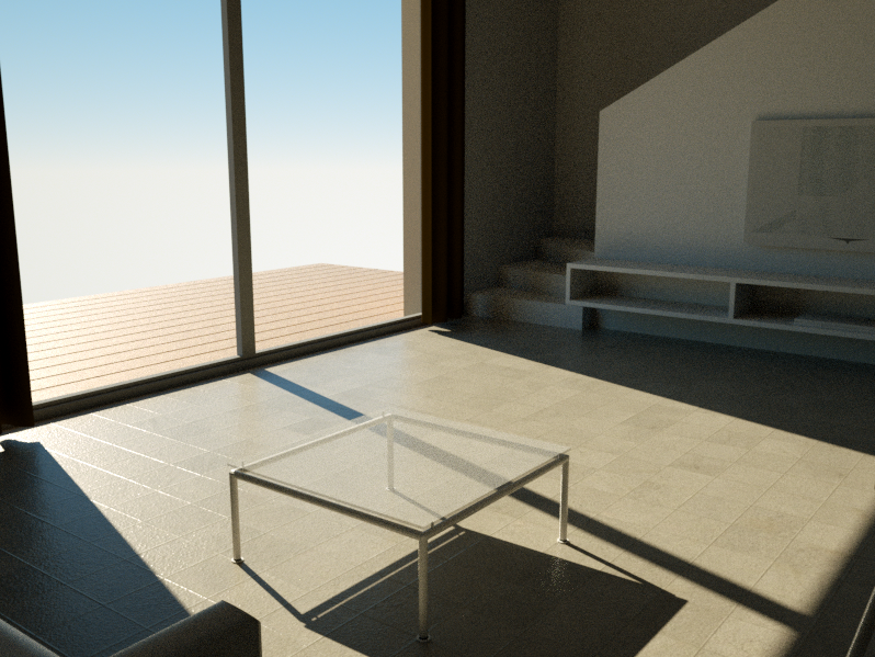

Goodnight,
to start, congratulations for all the work you do to improve and Octane Render plugin for cinema 4D.
If the problem has already been mentioned, I beg you to excuse the duplicate.
My problem comes from the specular material.
As you can see from the first picture, the light does not pass through the bay window.
For as the sun enters the room, as in the second picture, I've been playing with the intensity of opacity.
Is this normal?
I used the 0.5.9 version and SDK 1.17 with cinema 4D R14
Thank you in advance

ashurao wrote: My problem comes from the specular material.
you need to activate the "fake shadow" option in the proper tab in the attribute editor for letting the sun goes through the specular material, and activate the "alpha shadow" option in the kernel setting ;)

not so unusual in an unbiased render engine ;)
even maxwell does not had any option for this for a long time, at least we have an option that solve the problem ;)
since the "fake shadow" (less) and the "alpha shadow" (more) options have an impact on the overall speed, they are desabled and must to be activated if needed.
anyway, any octane setting can be saved in a the classic new.c4d file, in order to personalize octane to your everyday needs ;)
