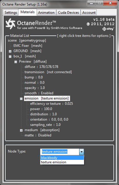

I have a question.
Once I made a mesh to an emitting light with -> emission -> texture emission or blackbody, how can I make the mesh a non-emitter again, please (w/o just setting to power to 0.0001 =) )?
I seem to miss the option to make it non-emitting.
Just re-convert the material from Poser, or flip it to a glossy and back to diffuse. At this stage there is no "disconnect node" option, but there will be in the near future.
