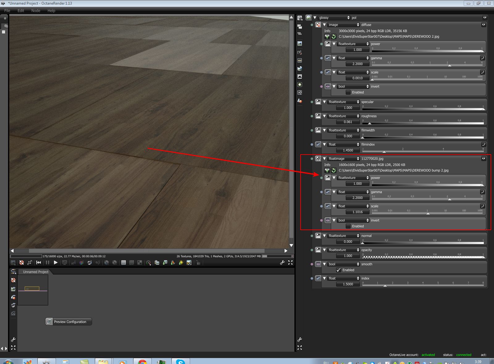

Bump does not work
the scale is not working correctly

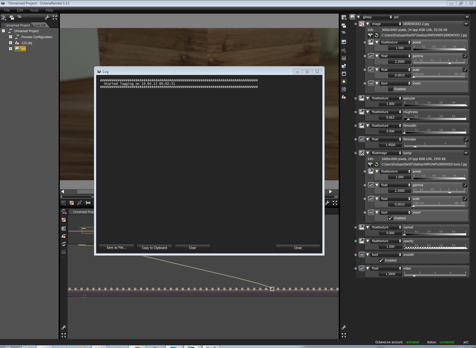

@ROUBAL: How many objects do the scatter nodes have in your scene? It may be that if you make the scattered objects transparent the renderer just becomes too slow. Are there any messages in the log (Help » Open Log) after it freezes?

@elvis: There is a problem with bump maps in Octane, sometimes the effect when using full power isn't strong enough. For wood tiles like this it should work. Make sure the scale of the scene is correct, if you check the camera settings the scale slider at the bottom shows you how wide the camera view is. A very uniform environment also makes bump maps hard to see.
