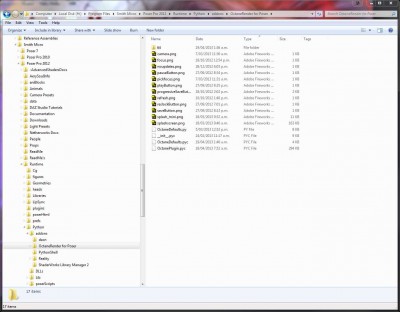

Hi Paul...
I just downloaded and unzipped the X64 version to my poser sub-folders, restarted Poser and now no "Octane Render" under the Render pulldown... how to I get it back?
WEB: http://rgus.deviantart.com/
GPU: NVIDIA GeForce RTX 3090 Ti
RAM: 64GB
CPU: 12th Gen Intel(R) Core(TM) i9-12900K 3.20 GHz
OPERATING SYSTEM: Windows 11 Pro
OCTANE PLUGIN VERSION: 2025.6.0.4.09 Prime BETA
DAZ STUDIO VERSION: 4.24 Pro Edition (64 bit)
face_off
Posts: 15830
Location: Adelaide, Australia
Sounds like it installed in the wrong folder. Did you delete the previous version? (I normally don't - you can safely install new version over the top of the old ones).
You only need ...
Poser Pro 2012\Runtime\Python\addons\OctaneRender for Poser\__init__.pyc
to get the OctaneRender menu item to show.
Paul

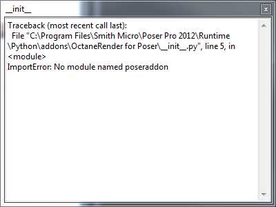

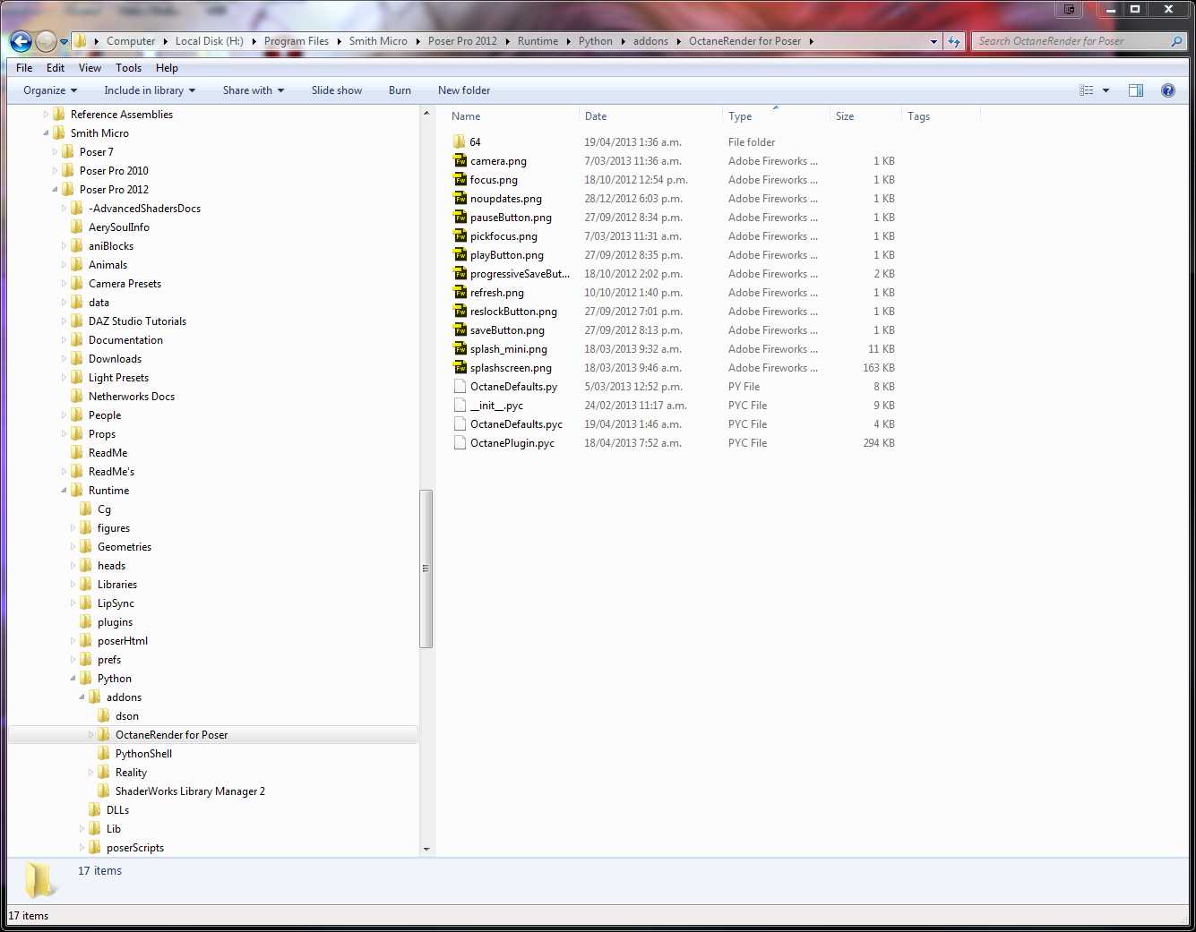

OK checked the file exists in the correct folder... image attached...
Ran the python script manually from Poser File pulldown menu... and got the second image error message.
If you say re-install Poser, I'm gonna spit the dummy...LOL
Any glues?
path image_002.jpg (12.55 KiB) Viewed 5538 times

Oh and BTW paul... after doing all that... still no Render Octane option... though I have been able to get it to work under the 32bit version of Octane... sort of defeats the purpose of an i7 though.
Regards,
Deane
