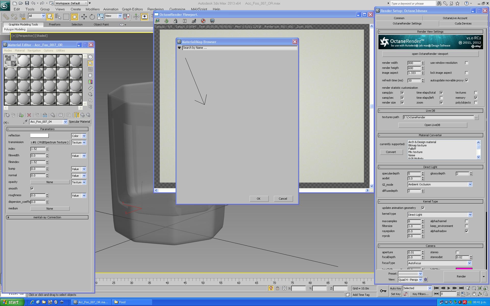

hi karba, i have a error when i close 3dsmax later octane was rendering, when i open a new work sheet, the material option appear gray without option, i need restar the machine to work with the new scene
i add image
