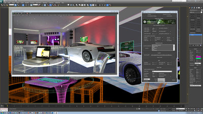

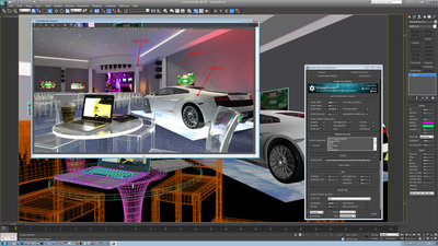

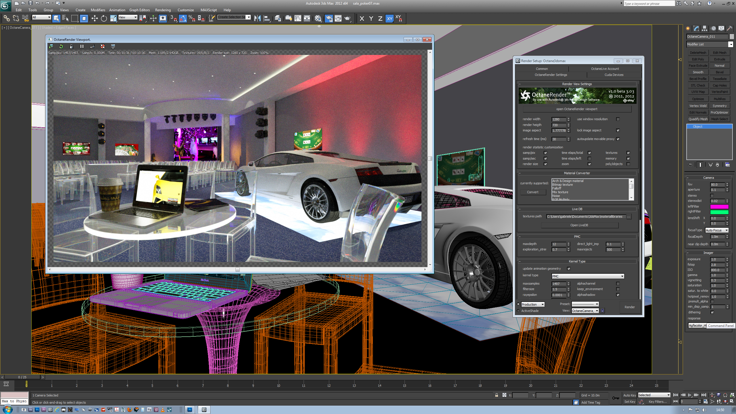

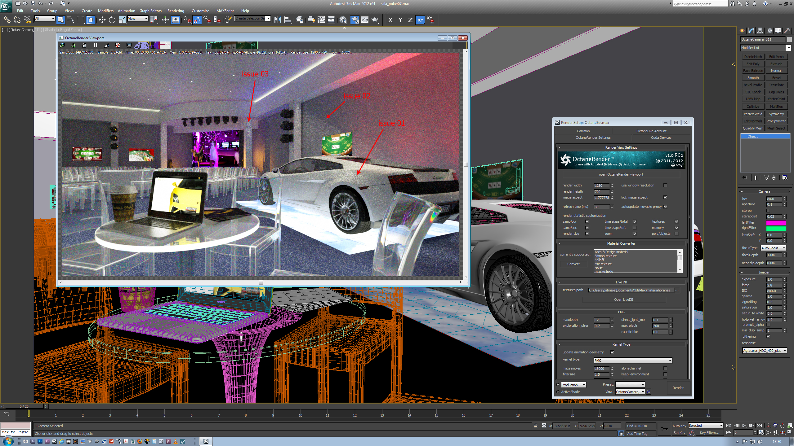

@Karba
please check these print screens.
I did some comparisons between 3.01, 3.03 and RC2
The RC2 release doesn't show wrong illumination when we use simple lighting planes.
In complex scenes with complex lighting RC2 falls (fails).
As you can see the test done with the RC2 is the worst.
I haven't investigate the cause, if you want I can send you my scene. Nothing was touched in these 3 examples.
You can notice evident differences: much more noise, wrong translucency (see the stage pillars), wrong ies distribution/illumination.
Regards

gabrielefx wrote:@Karba
Regards
I can't reproduce this IES issue.
Can I have your scene (without the car and furniture)?
[email protected]
