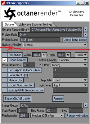

- Elvissuperstar007
- Posts: 2620
- Location: Ukraine
- Contact:
why only plugin for 3d max no Native Unit size ? This function is very important
- Attachments
- snap.jpg (75.01 KiB) Viewed 4945 times
