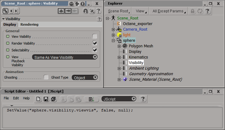

To check if the parameter in xsi6.5 is the same as i checked, open the explorer, double click the visibility and uncheck the "View visibility" checkbox.
Open the script editor and show the message.
It should like as the first image below.

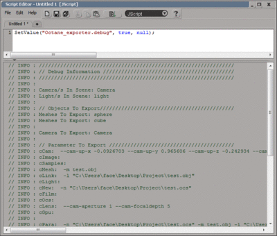

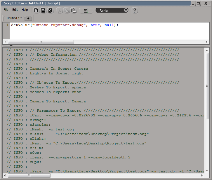

You can also use the debug information.
To use them, enter a command in the script editor and execute the command.
After that, hit any render button. Preferred the render frame button while then you don´t want to select an output image and the Octane scene must not exists.
Now you becomes some infos. Important for you is the upper section. There you can see the objects that will exported.
See the output and the command on the last image.
