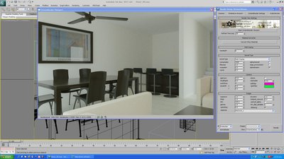

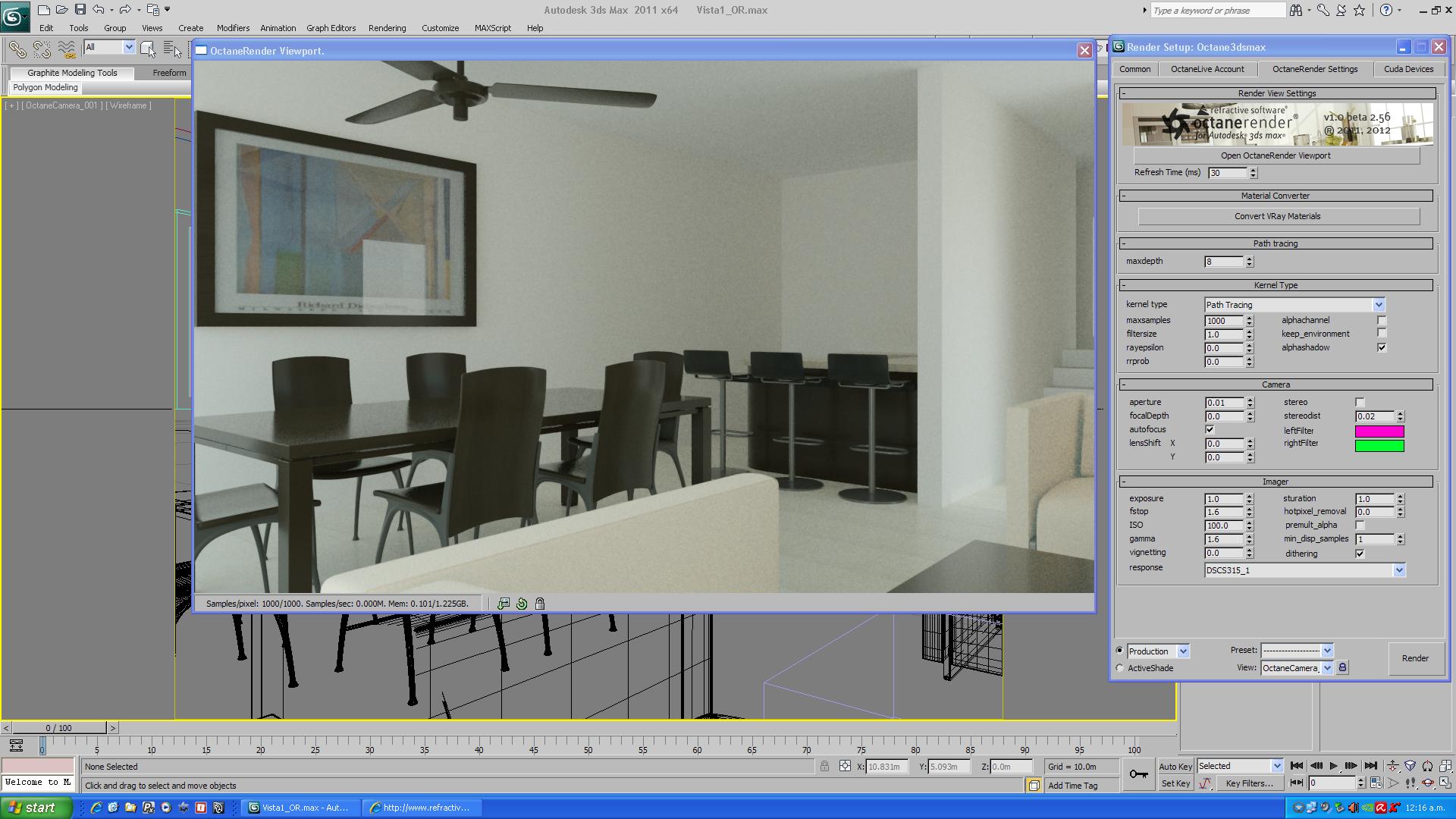

Can you compare this scene with standalone render?merid888 wrote:hi karba still my interior have noise, is not cleat the image and i don't know why
maybe is a problem of my configuration, maybe is an parameter of octane for max becouse i can't understand why i can't do a nice clear image like stand alone licence
i add image
- gabrielefx
- Posts: 1701
- Joined: Wed Sep 28, 2011 2:00 pm
after 1000 samples you can't have noiseless images. This scene is an indoor space, needs more samples.merid888 wrote:hi karba still my interior have noise, is not cleat the image and i don't know why
i add image
quad Titan Kepler 6GB + quad Titan X Pascal 12GB + quad GTX1080 8GB + dual GTX1080Ti 11GB
