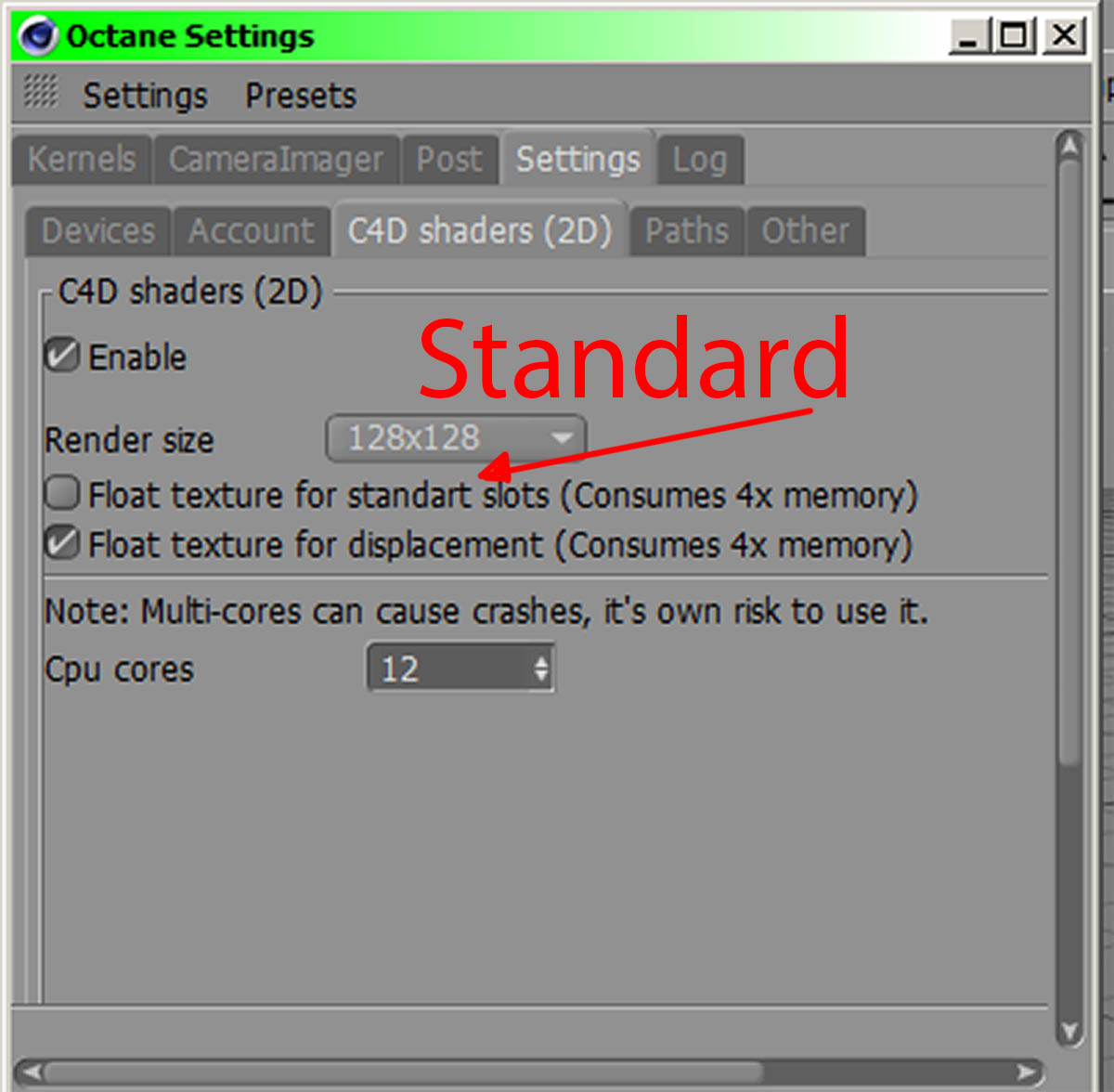

Ups, aoktar, bad mistake :)
Can you change please the spelling mistake state kind (Standart) in standard?
State kind (Standart) is absolutely wrong.
Thank you Rudi

Rudi wrote:Ups, aoktar, bad mistake :)
Thank you Rudi
thanks, for next

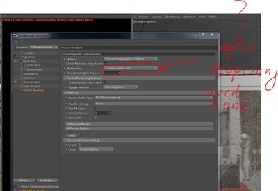

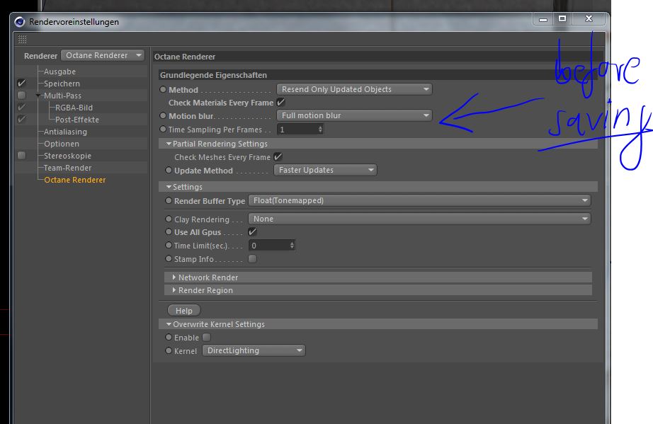

The other thing is, that octane 2.03 does not remember rendersettings in saved file.
I set "Full Motion Blur" and save. After reopening saved scene Motion Blur is set
to "Camera Motion Blur".
Again, what else should I tell you. No bugreport is created.

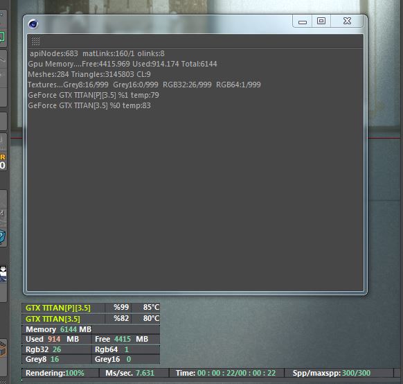

VRam usage seams o.k. Have 2 Titans and GPU-Z says, that about 1,7 Gig is used.
It seams to only occure on anim. rendering.
Where or how can I check tesselation, please?
thanks
Mike
if you have freeze on anim. rendering, i don't think it's a bug. %99 is a user problem. If you have hypernurbs, check render subdivisions. Are you checking vram while doing animation rendering? What's the triangle amount which is seen on Live Viewer?

Btw. what do You think about render settings always jumping back
to "Camera Motion Blur"?
thanks
Mike
ok, i can't see a problem with imagesequences. Hard to tell something about freeze. Keep LV and octane windows are closed while rendering.
Also camera motion blur changing, it's not a problem. Even, i haven't see that before. Please try with a older version.
