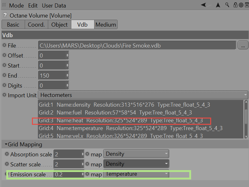

Hi Dev Team & Aoktar
My VDB source has several fields.
I want to put "Heat Field" to "Emission".
Could you make it? :?

eyeonestudio wrote:Hi Dev Team & Aoktar
Can you send me this vdb?

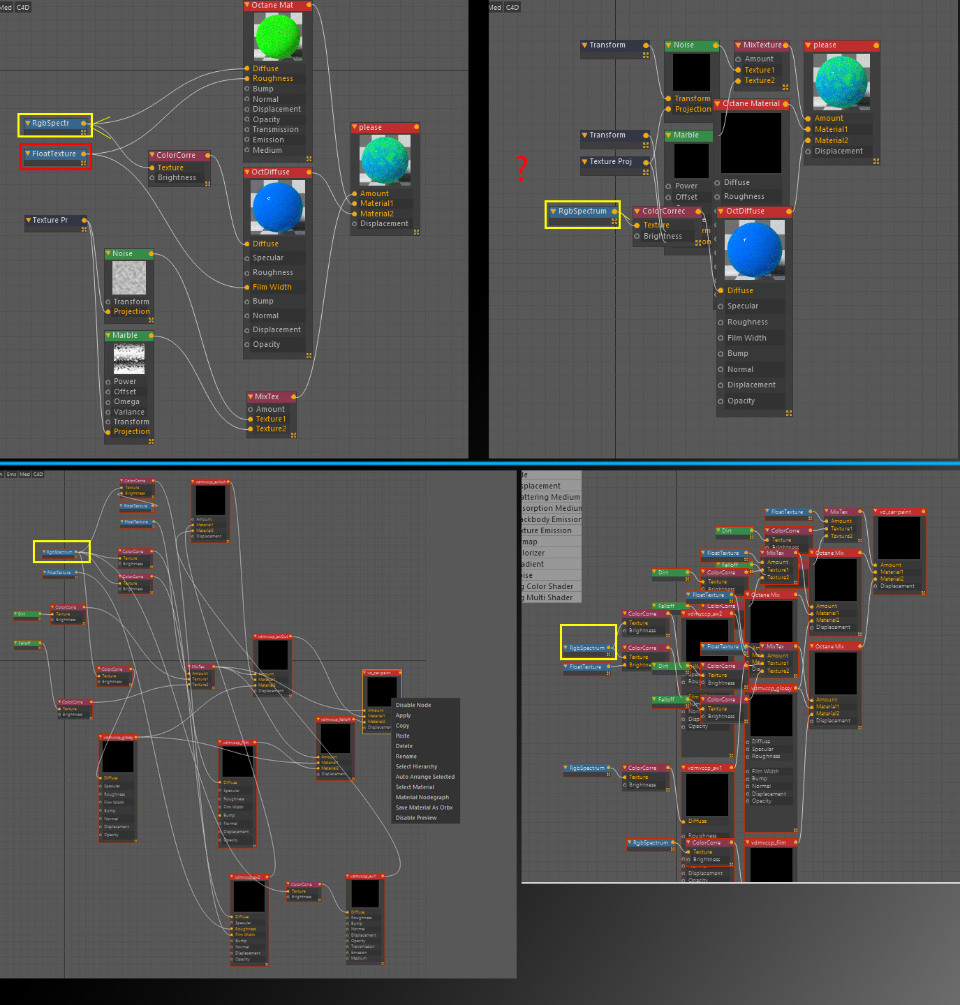

Good day. Thanks for the amazing daily work! Here is small report/request from me but if all that was said before just ignore my msg :)
On the left side of the image we see created material and on the right side we see same material imported from LiveDB (same thing on both v2 and v3)
1. [NE] Rgb Spectrum node lost some connections and recreate it self few times taking a "friend" ColorCorrection
2. [NE] Float Texture node missed totally
3. [NE] Transform node creates self always individually for each second node it was connected
4. [NE] [request] Position of nodes unchanged. Means they are located same place where they was/planned by author
5. [NE] [request] Shift + Click to select multiple nodes
6. [NE] Right Click/ Save Material As Orbx not working
7. [NE] If you copy main mix material from attached file to a new project you can expect unlinking of some node connections
8. [NE] Sometimes Preview Materials all just black even drag not helping (if to turn Upd. Preview on Drag)
I will pray that someday node positions will be saved as it was seen by author before material export and there will be no "self recreation" of them. Because that will be super powerful for creating "smart" materials
9. [Devices][LV] Wrong indification of GPU list:
GPU0 in PC == GPU1 in OR and temps in LV from GPU2
GPU1 in PC == GPU0 in OR and temps in LV from GPU0
GPU2 in PC == GPU2 in OR and temps in LV from GPU1
Thanks for attention :)
