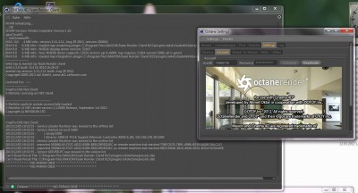

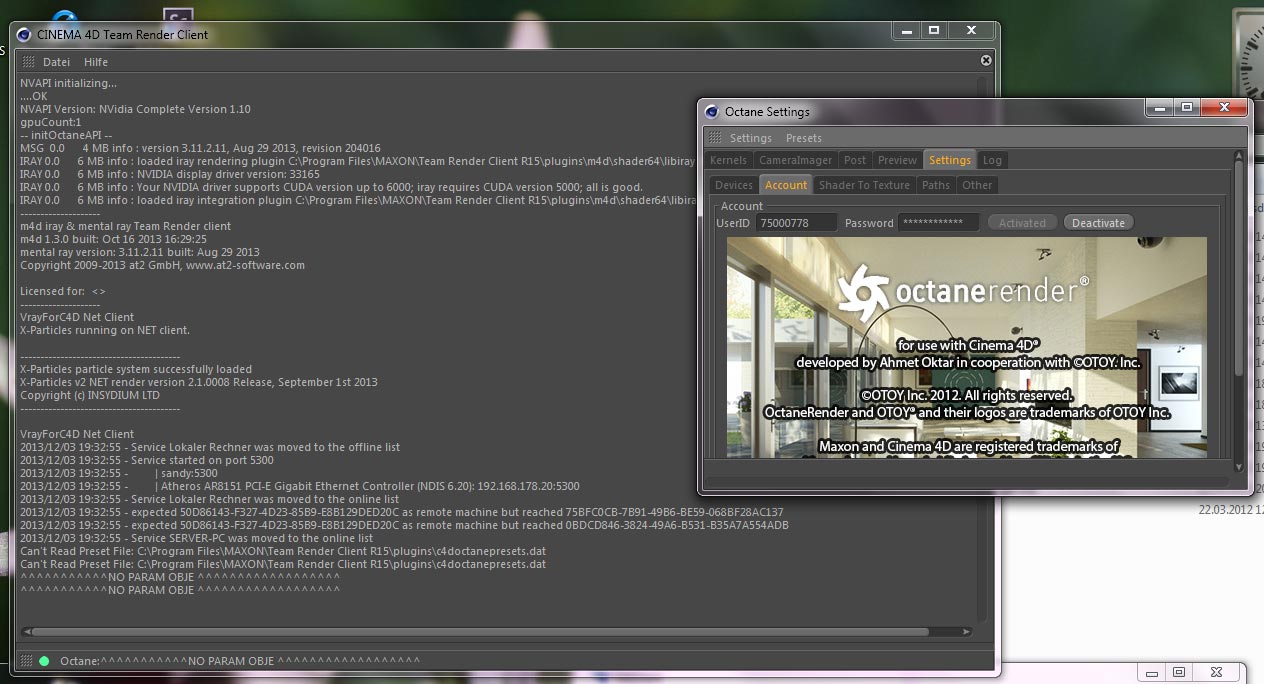

Andygp wrote:i have all done, but Teamrender gives no Pictures, with Standart Renderer it does, i have a simple quader scene in with 100 frames no textures, no chance to render
what do you read on client console? like that? If it's yes, you still copied a oct.dat has empty account.
Try to first run R15 and register the plugin, then copy new oct.dat here again.
-- initOctaneAPI --
Empty Account/Password!!!
Initialization error!!!!
If you still can't do it we have a Second solution:
run client as not a client, only open and leave at normal running mode

How can i run as not a Client, the Teamrenderclient as not a Client ?
I have now test it with my Laptop and Windows 7
Nvidia Titan, Nvidia 580, Nvidia 590 on evga dual 5690 48 gb Ram
