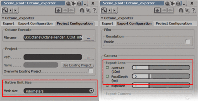

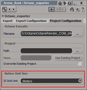

A quick report.
I have begun to integrate the native unit size.
With that you can choose which unit your gridsize is.
The exporter also calculate from your choosen unit to Octane meters.
face

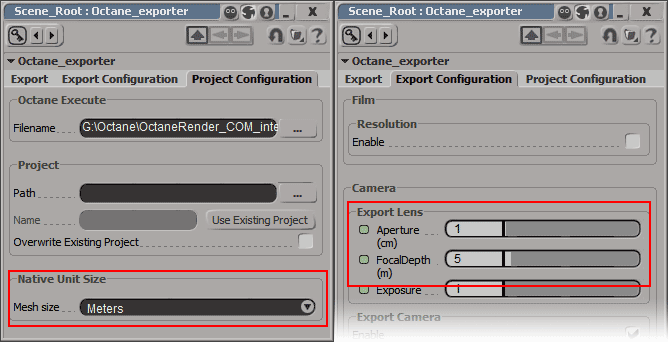

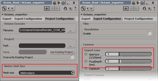

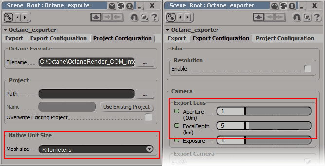

Have continue working after some logical issues.
I have renamed the "SI Grid Unit" to "Mesh Size"
To undestand it, it´s assumed that 1SI unit is 1meter.
If your mesh is modeld in mm, means, the grid is greater as the mesh, then choose millimeter, the aperture and the focal depth units becomes automaticly the right units.
Hope thats better understandable as a fixed aperture/focal depth unit.
