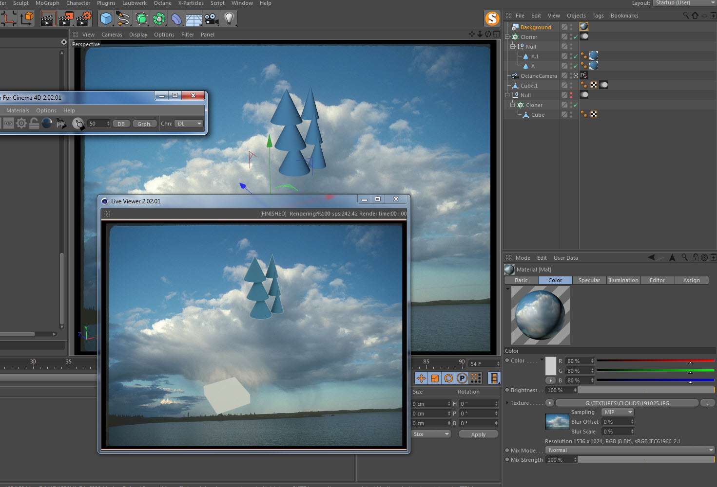

LFedit wrote:
can anyone confirm this is working in 2.02 i'm not seeing back/fore. objects with diffuse texture in LV or picture viewer, thanks
I went back to 1.52 and tested, it worked. Reinstalled 2.02 and it's working. Must have had a strange install. Thanks Aoktar, keep up the awesome work!
strange, it's working as seen in picture. Thanks

aoktar wrote:
Tried that, but getting only distorted background image in LV. Adjusting texture tag settings has no effect.
Any advise?
