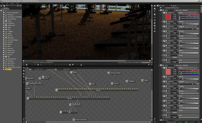

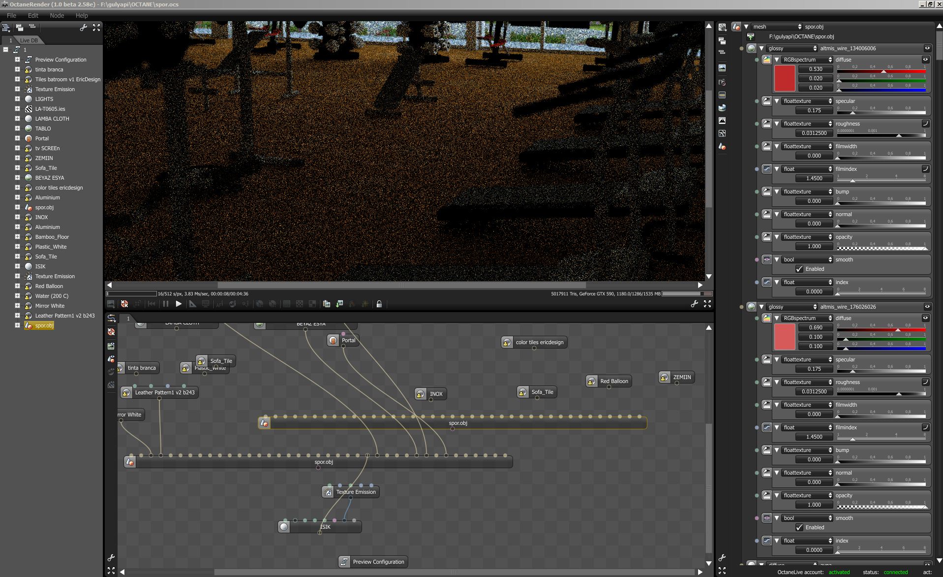

if i want to use camera only option. Octane imports many unwanted copy of obj files. and this error causes very big time losses in big scenes.. (double voxelizing, parsing faces etc.)
if i unmark the checkbox of camera only option.. There is no problem..
i hope you response quickly..
