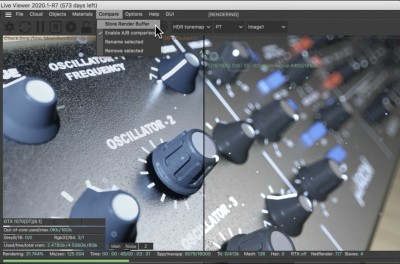

Posts: 10661
Hi Weirdpictures,
after enabling the AB Comparison, you also need to use the Save Render Buffer command, since it is not stored automatically like before.
Then you will see the AB line, and use the Compare feature as before:
ciao Beppe

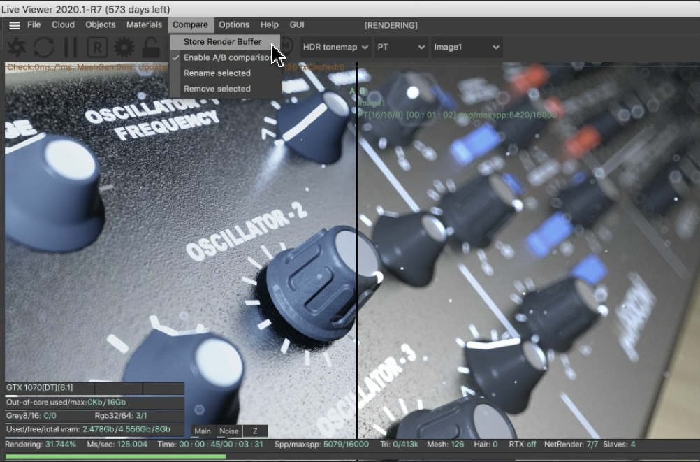

bepeg4d wrote:Hi Weirdpictures,
The attachment DC178A69-66A0-489A-9077-3B6A6AED8929.jpeg is no longer available
ciao Beppe
Hi Beppe,
thanks for your reply. Yes, we know that we need to save the render buffer, but it wont show up or give us the red line to compare between two images.
Here is a screen recording to show the problem. Again, all works perfect with the R5 release, but R6 and R7 have this problem for us.
Test Capture.wmv
This shows the problem.
(10.18 MiB) Downloaded 3988 times
