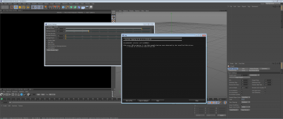

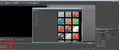

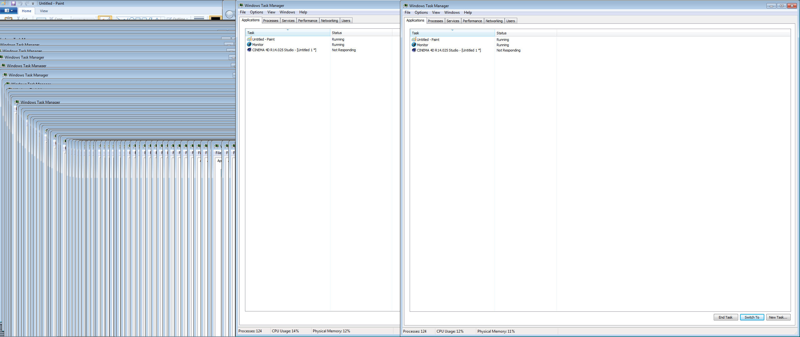

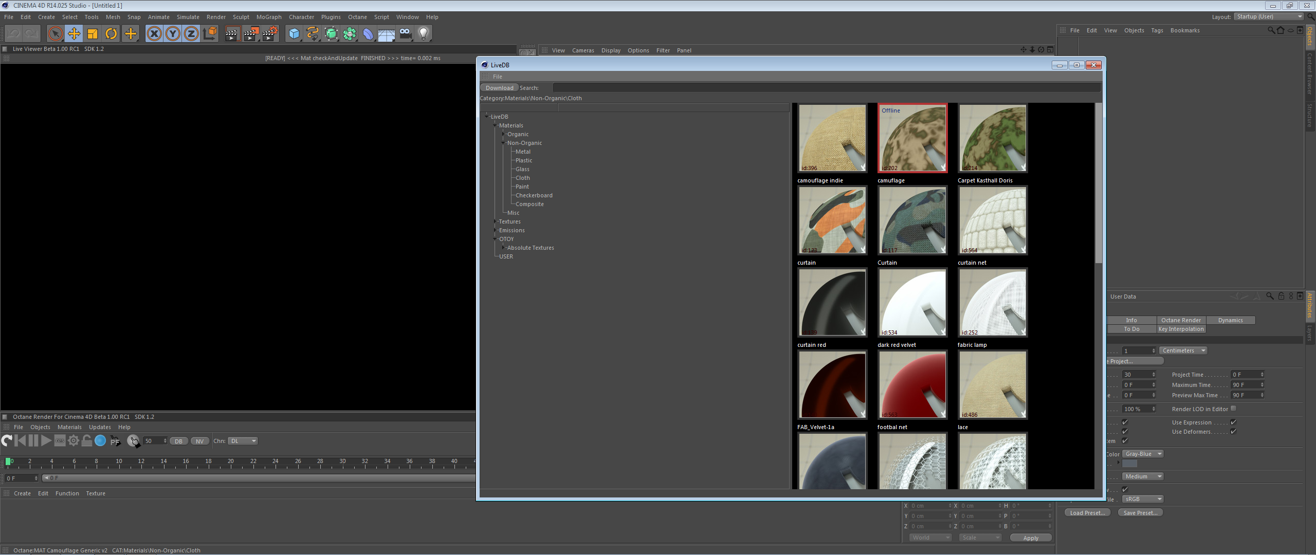

Problems with the new update.
installed like normal.
so here's the problem.
clicked make it offline or download.
seems manage to download it right? then i clicked on the material. Cinema4D crash and not responding some other problems. i clicked download on leather black. it says download complete. but no material icon come out. Cinema4d install path
Computer > localdisk (C:) > Program Files > MAXON > Cinema4d r14
using cinema 4d studio.
hardware specs
motherboard = MSI MpowerMAX
GPU = MSI lightning 780
RAM = 32 GB
OS = windows 7 ultimate 64bit
i wonder if the software manage to download it but cant fetch the files because it is save on places it cant recognized.
hardware specs
RAM = 32 GB

wetfusion: could you check the video which have pointed some usage of offline? Making offline takes long as downloading. Livedb downloads the material and convert it to a mat file which is under LiveDB directory structure.
Not response sounds like that. If you didn't wait to complete this process, this can be i think.
Thanks aoktar for the fast reply. before anything i would like to say thank you for the amazing work. and thank you for patiently answering all my question.aoktar wrote:wetfusion: could you check the video which have pointed some usage of offline? Making offline takes long as downloading. Livedb downloads the material and convert it to a mat file which is under LiveDB directory structure.
i did check the video. and i follow it precisely.
the problem is not offline mode. even if i download it directly. this will happen.
notice it says 'download complete'.

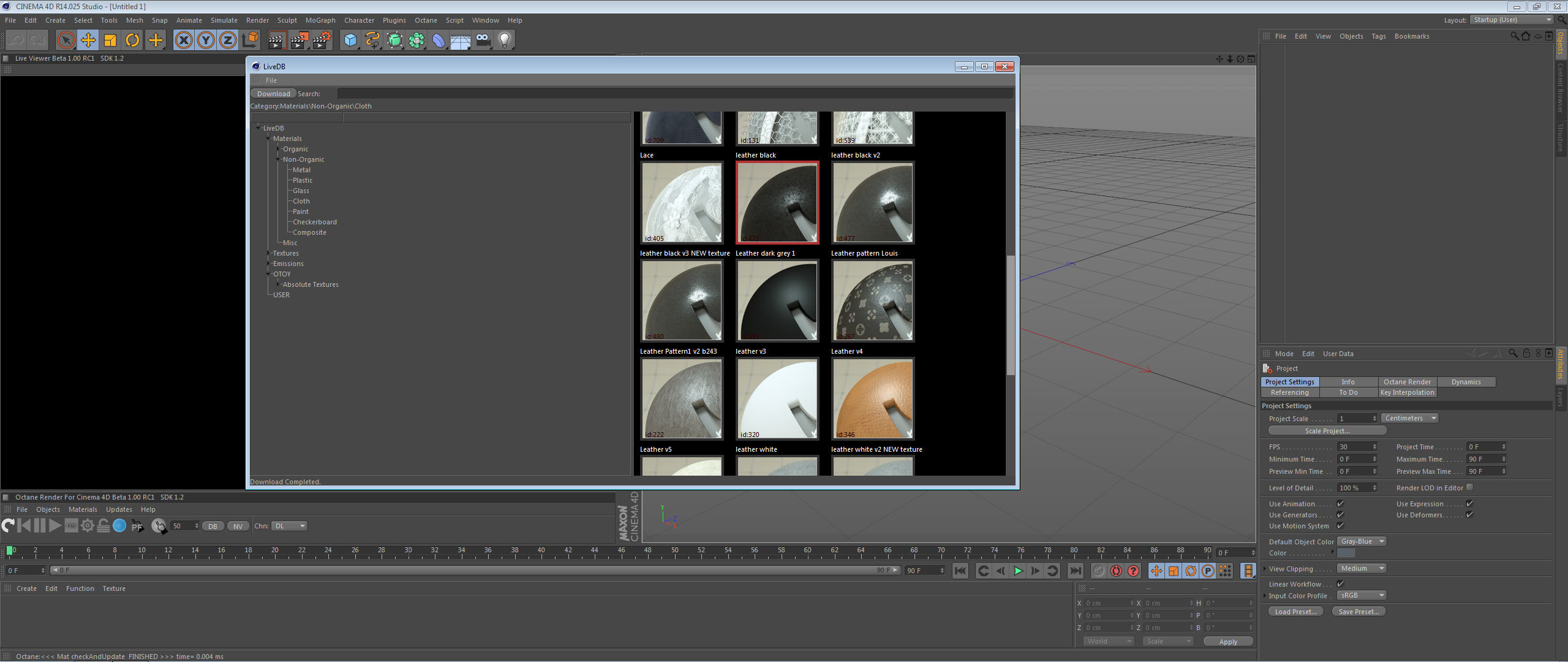

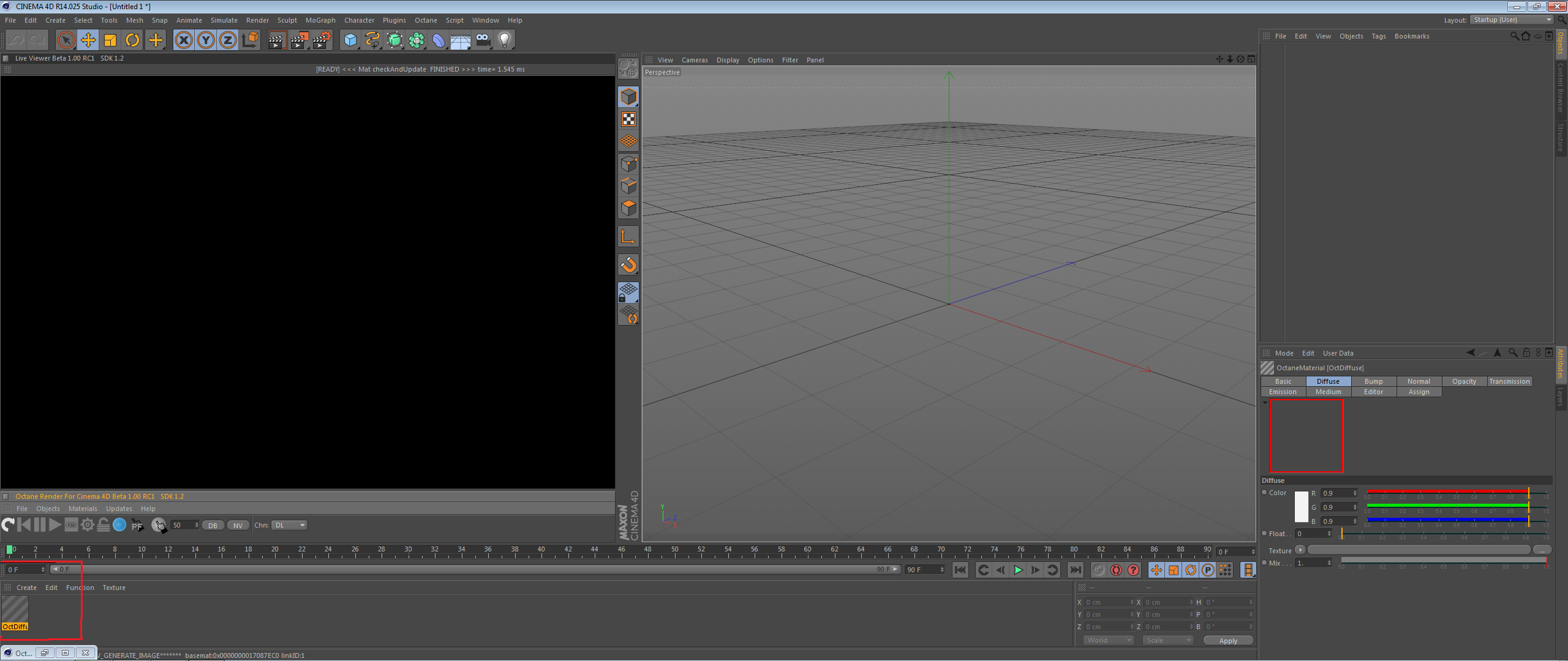

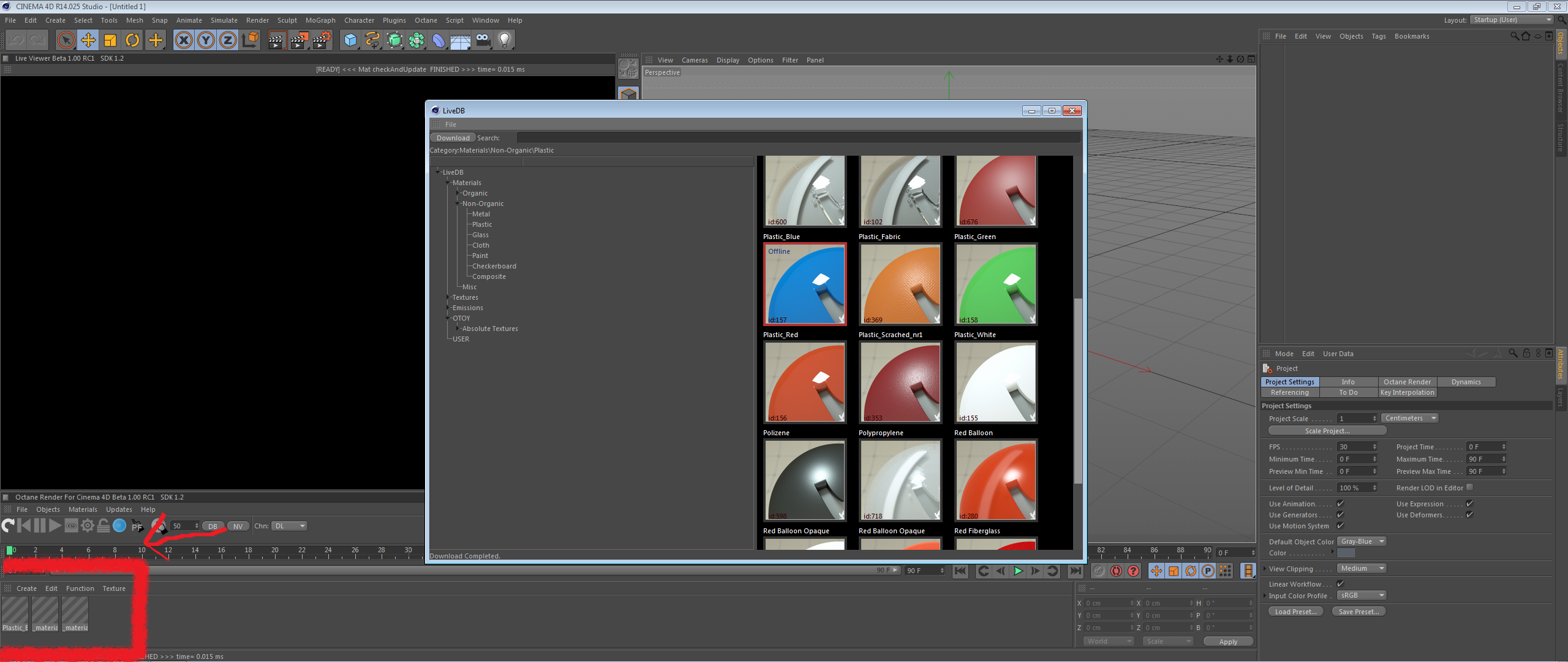

wetfusion: cool. but material had been dowloaded but cannot made previews. what's your plugin version? this should be working on last versions. also if you click the material that will generate.
im not sure where to look for the plugin version.aoktar wrote:wetfusion: cool. but material had been dowloaded but cannot made previews. what's your plugin version? this should be working on last versions. also if you click the material that will generate.
intel 17 4770k (MSI MPOWER MAX)
32GB 1866ghz corsair dominator platinum
2x MSI 780 lightning
Plextor M5 256GB
Plextor M5 256GB
ok, click to start render in octane dialog for this. Seems this occurs simetimes.
