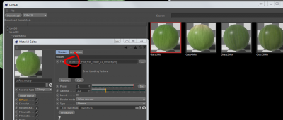

I was planning on building my own Octane material library in the LocalDB - but I got path troubles. See image:

martincarlson wrote:I was planning on building my own Octane material library in the LocalDB - but I got path troubles. See image:
There is no trouble. Texture are in orbx. You need to work on a SAVED scene because it extract these files to PROJECT_DIR\TEX\ASSETS.
Ahh! Ok!
Sorry for behaving like a retard Aoktar. But, do you mean I have to save the document before I drag it to the LocalDB? Or do you mean the new document I import material to has to be saved first?
