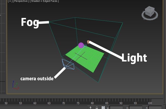

hello jai a little problem on light volume it does appear that pass questions why i did wrong, I do not understand
forgive me for my english google
thank you
roeland
Posts: 1826
Your screenshot doesn't show any settings, so I can't tell if anything is wrong here. What are the values for the inputs to the specular material and the scattering medium?

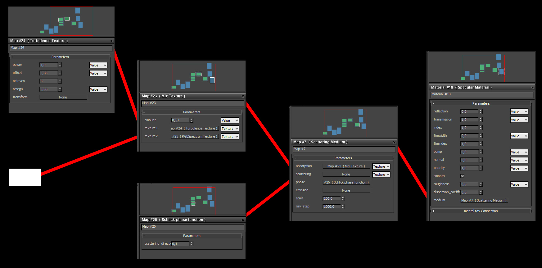

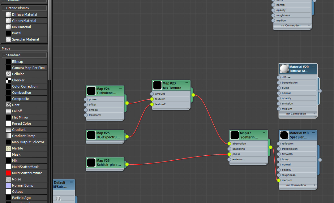

roeland wrote:Your screenshot doesn't show any settings, so I can't tell if anything is wrong here. What are the values for the inputs to the specular material and the scattering medium?
Roeland
Hi, excuse me here is the detail of the parameter
thank you again
roeland
Posts: 1826
For fog you need a low scattering value, and no absorption. Set absorption to 0, scattering to 1, and the scale input, which is multiplied with these two numbers, to a low value like 0.1.
