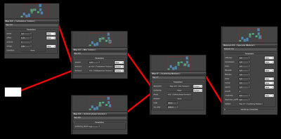

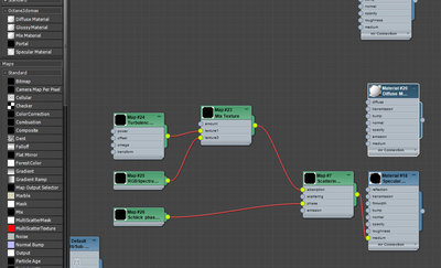

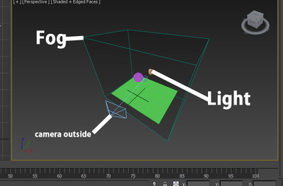

Using medium nodes
Merci beaucoup mais alors ces très tres longroeland wrote:For fog you need a low scattering value, and no absorption. Set absorption to 0, scattering to 1, and the scale input, which is multiplied with these two numbers, to a low value like 0.1.
Roeland
mais sur 3gtx 590
Roeland
Thank you very much but then these very very long
but 3gtx 590
