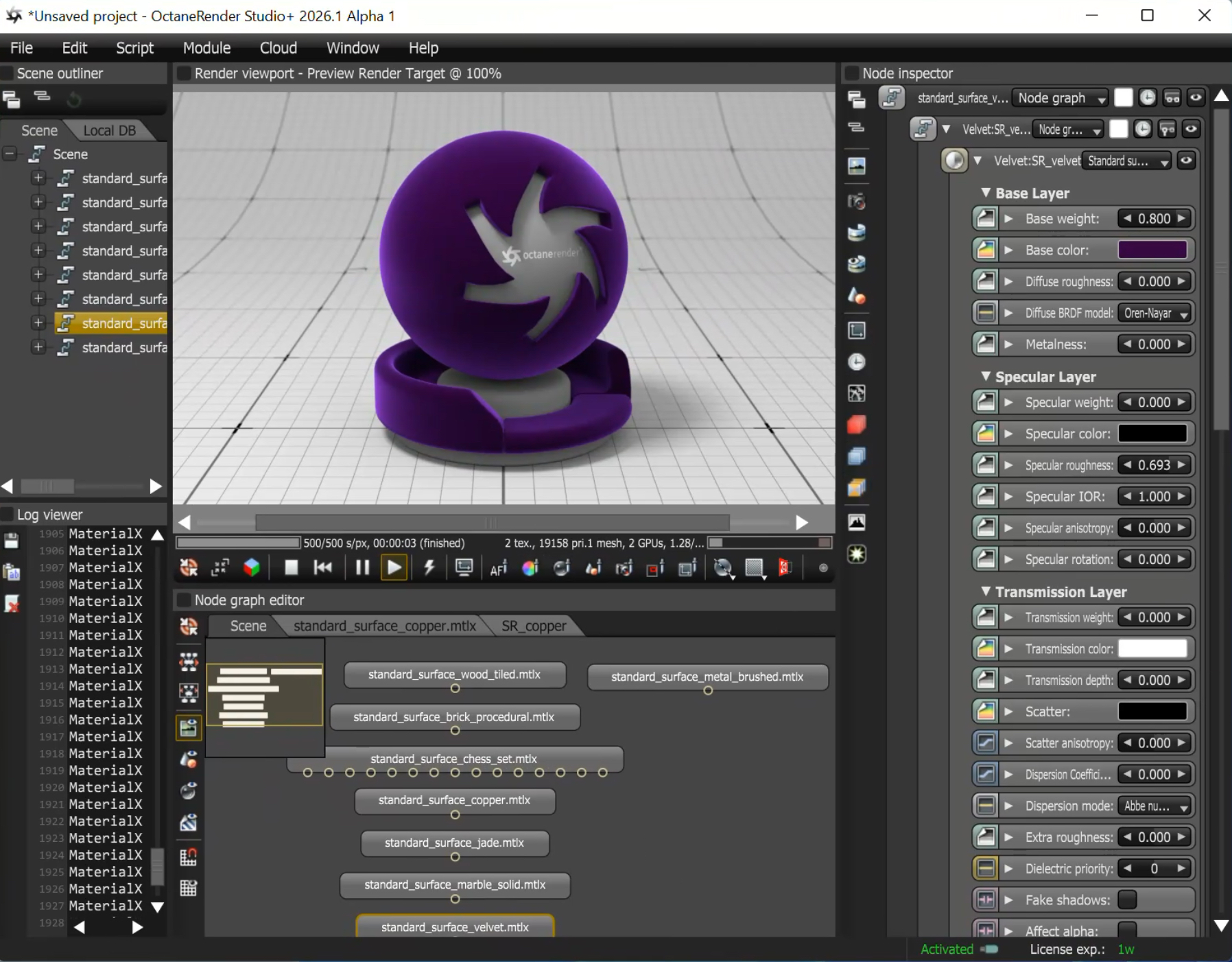

Tugpsx wrote:Anyone with a working sample of a MaterialX scene? curious on how to setup the nodes in Octane Standalone.
you can find some materialx examples here:
https://github.com/AcademySoftwareFound ... ardSurface
Just download and drag and drop in Graph Editor:
ciao,
Beppe
Tugpsx
Posts: 1180
Location: Chicago, IL
Thanks for the information, I should have read more clearly to realize that the PBRs are not ready yet. :D

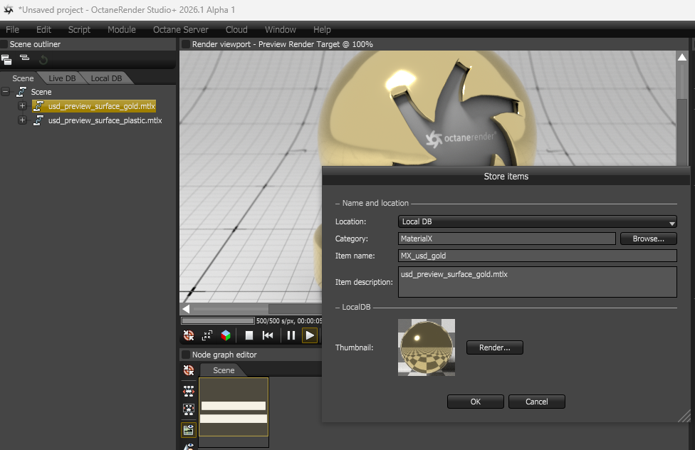

This is extremely helpful since I'm looking for a way to add them to the Daz Octane plugin.
I have added some to the LocalDB which I can then share within the Daz plugin.
MaterialX saved to LocalDB

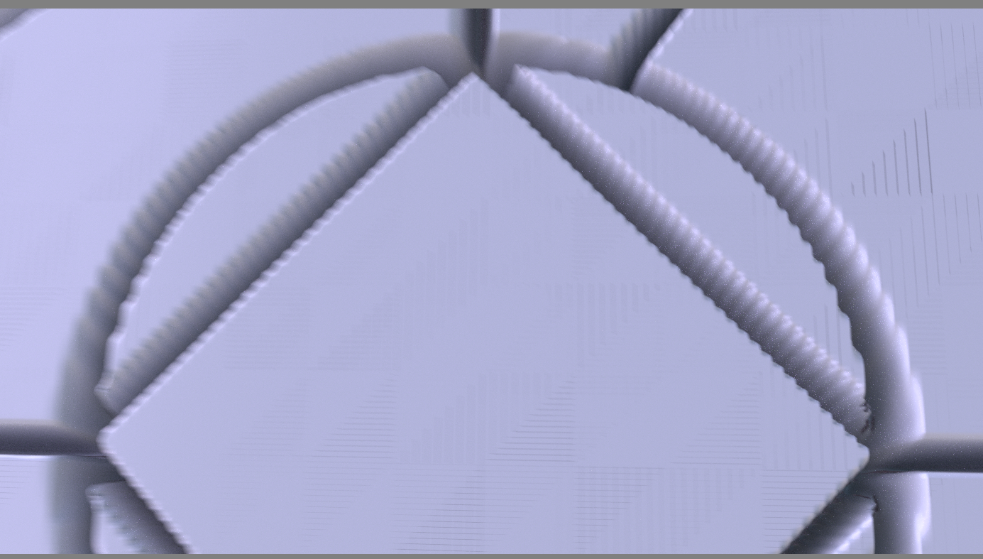

How to enable 16K in texture displacement?
I have a 16K texture, and the shot starts from extreme close up. While 2026 greatly improves quality, it's still jaggy, and filters don't do anything
2024-12-26 19_37_02-_D__Motheland Dropbox_Daniel Shamota_MBE_ORBX_sh030.orbx - OctaneRender Studio+ .png
frankmci
Posts: 917
Location: Washington DC
Four or five years ago it used to be that Displacement maps had an 8k limit while other textures were limited only by VRAM availability. I don't recall if that has been changed since then, and a quick search of the forums isn't turning up anything newer. I would expect it to have been stated in release notes at some point if it had been increased. I may have missed it, though. The UI for Texture Displacement in Octane 2023 for C4D still has the 8k limit built in, but I don't know if that limit applies to Vertex Displacement, too. (I'm guessing that most development for the older, texture displacement system has stopped, except for bug fixes.) If it does not, and you wanted to use a 16k displacement map, you'd need a pretty insanely dense mesh, at least in key locations.
In your situation I think I'd try to use multiple displacement textures on multiple pieces of geometry for different LODs as the camera pulls back. If you can't fudge it in a single shot with multiple pieces of geometry and multiple textures scaled appropriately for camera distance, then you can do it the old fashioned way and render multiple sequences with appropriately placed and scaled textures for several distances, then dissolve between them.
I think there was some talk of dynamically generated mesh density for displacement at one point, but I have no idea if that is still in the works, or if it was just the old, "...tool X has it so why doesn't Octane?" chatter.
