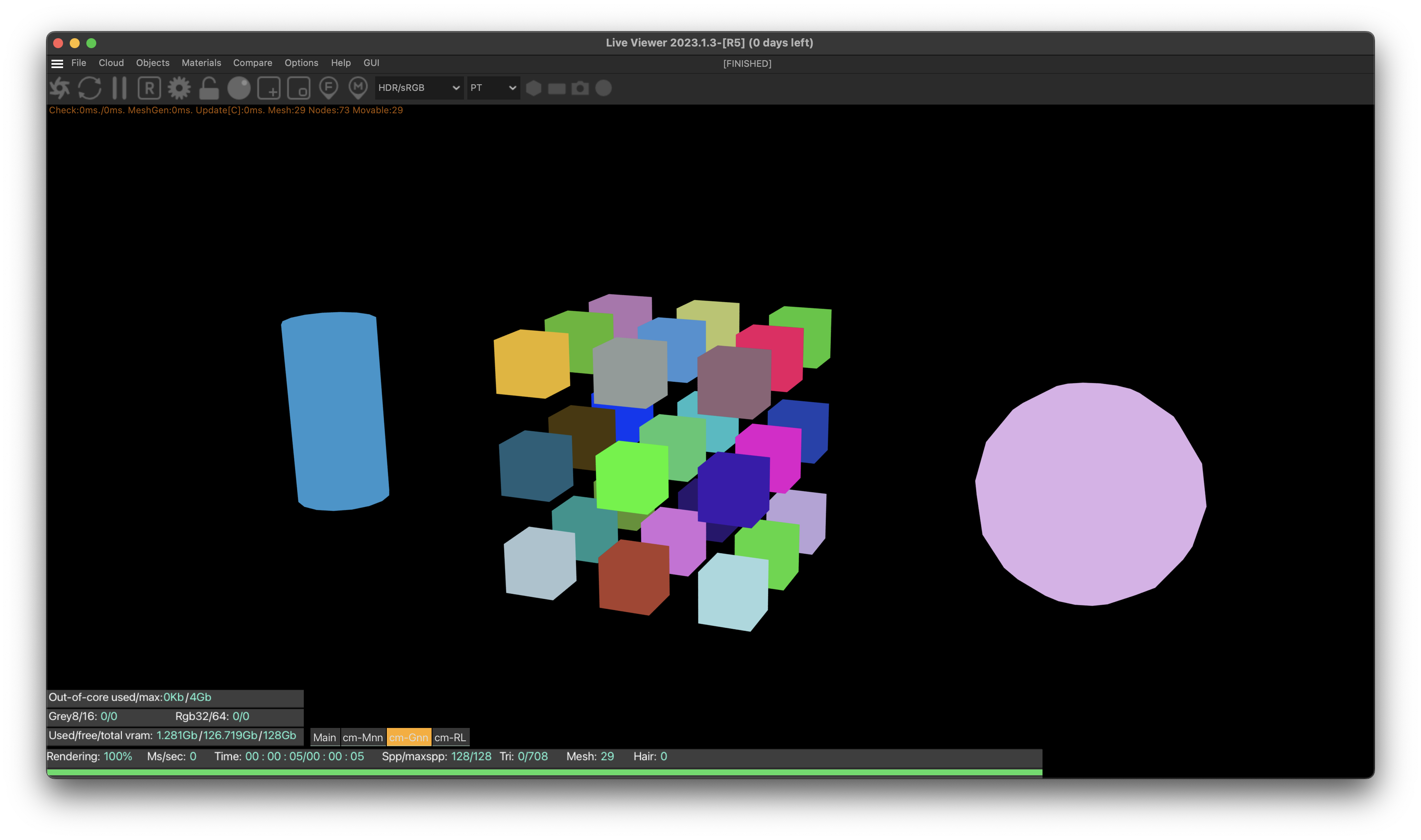

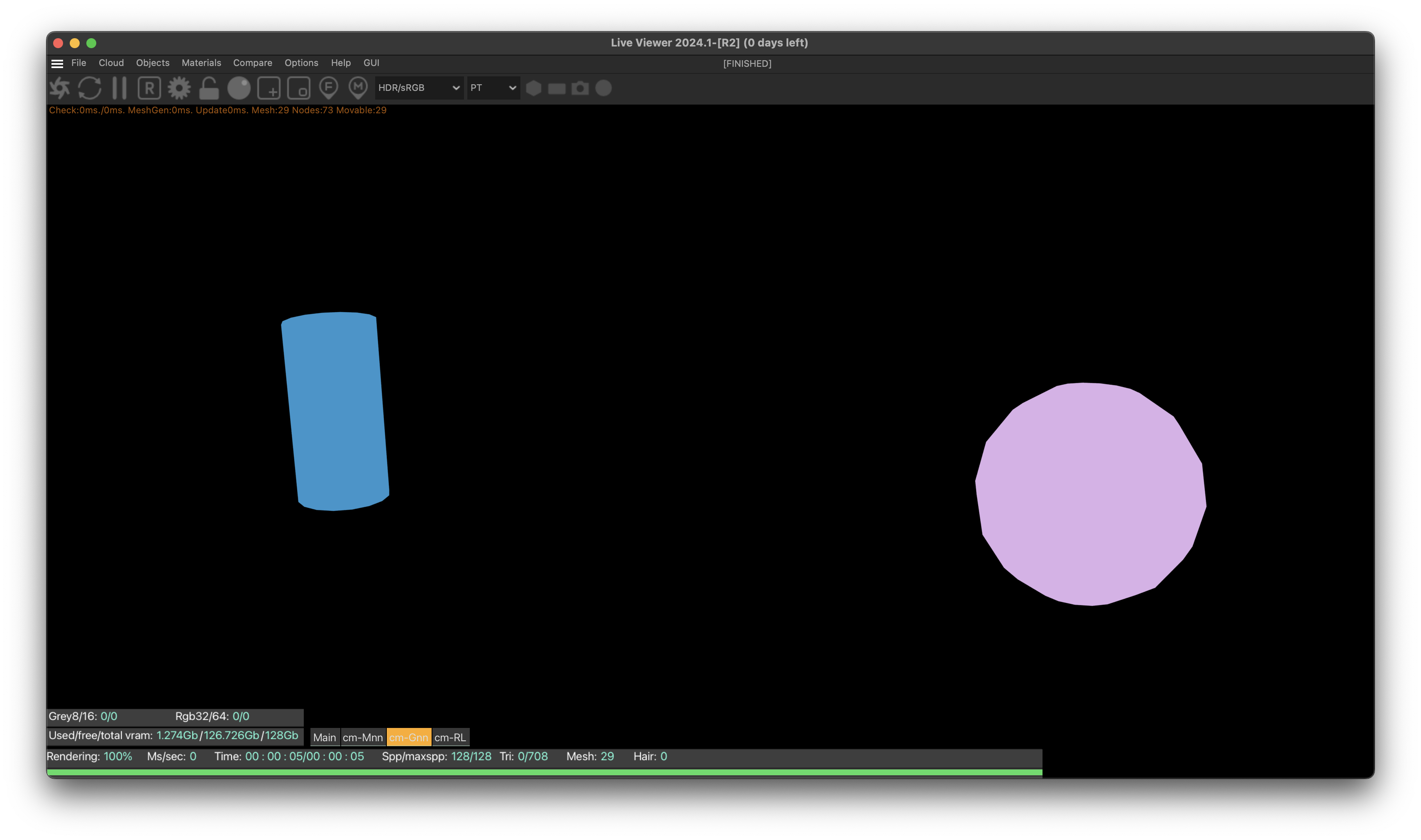

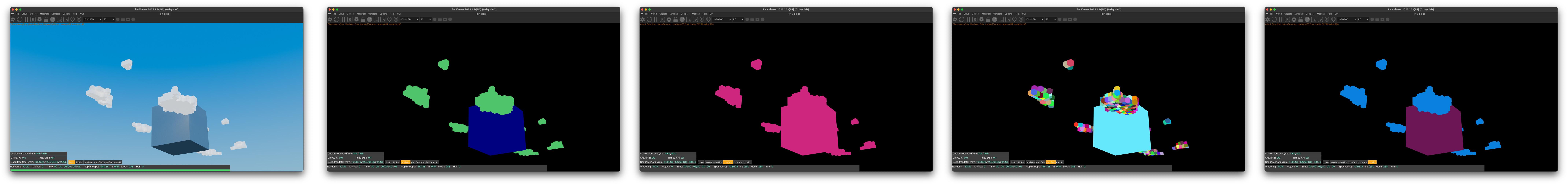

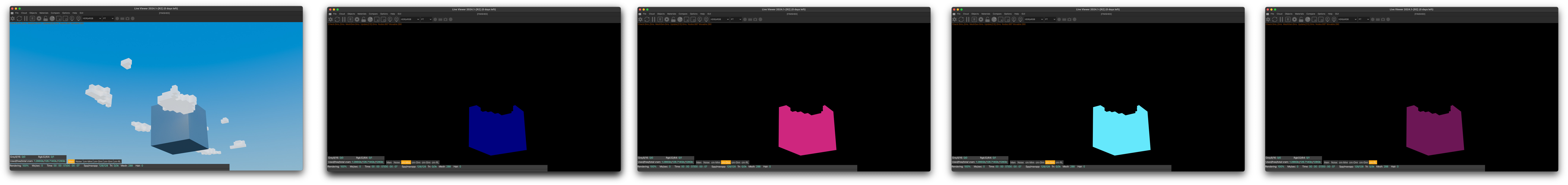

Having troubles in the latest Octane C4D Plugin (2024.1.R2) with Cryptomattes not recognizing objects that have materials that contain emissions. If I either render them in an older version of Octane or disconnect the emission node from the Universal Material on the cloner, the cryptos work correctly.
macOS 14.6.1
C4D 2023
Octane 2023.1.3 R5
macOS 14.6.1
C4D 2023
Octane 2024.1 R2
Cheers,
Mike
Posts: 16068
Location: Türkiye
the_monkey wrote:Having troubles in the latest Octane C4D Plugin (2024.1.R2) with Cryptomattes not recognizing objects that have materials that contain emissions. If I either render them in an older version of Octane or disconnect the emission node from the Universal Material on the cloner, the cryptos work correctly.
macOS 14.6.1
C4D 2023
Octane 2023.1.3 R5
macOS 14.6.1
C4D 2023
Octane 2024.1 R2
Cheers,
Mike
Could we get your scene to check?

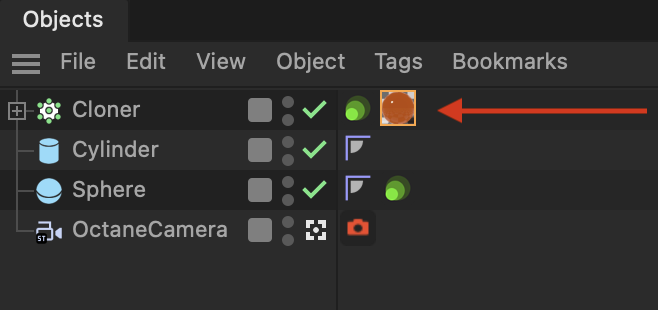

aoktar wrote:Could we get your scene to check?
Sure can, but it's underwhelming. ;)
Emissive Crypto Error [2024.1].c4d.zip
(89.91 KiB) Downloaded 209 times
I can reproduce it with a single primitive and emissive material, but I added a couple other objects for clarity.
If I drag the material between objects... whatever objects it's on looses it's crypto in the Live Viewer.

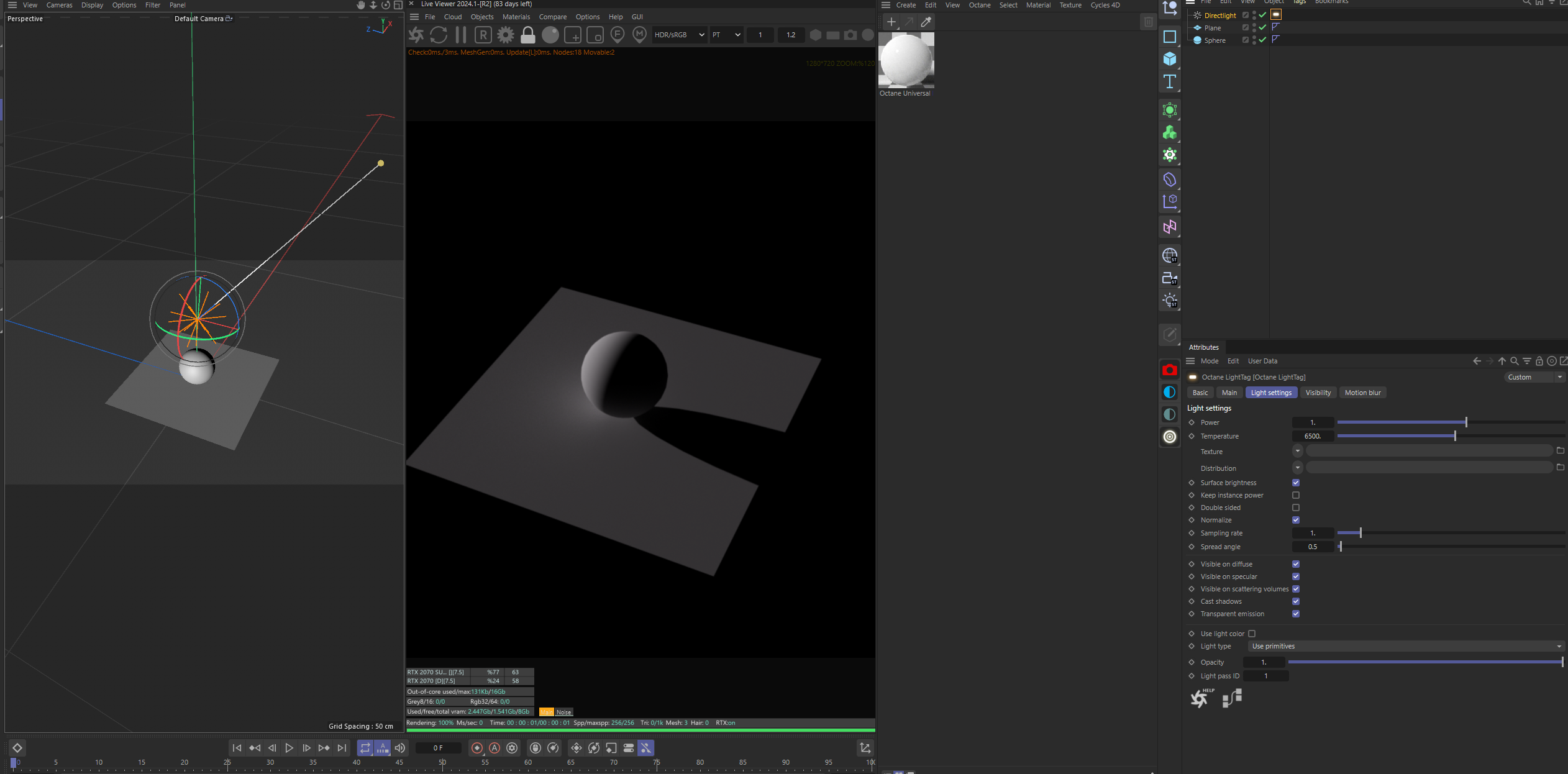

I might have stumbled upon a mismatch in direction for the Directlight? For some angles it renders correct, for others it seems to be 90°s or more off.
Tested with Plugin 2024.1 R2 and C4D 2025.0.2. The same scene renders correctly for the older combination of 2023.1.3 R4 with C4D 2024.5.1.
(I'll upload the scene if useful, but it's all standard objects and the default Directlight. I played around with the rotation order, but none seems to fit and YZX is the default for newly created Directlights, so I stuck with that.)
