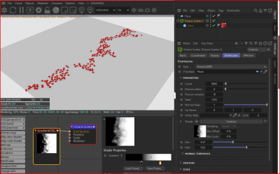

frankmci wrote:
Yes, but distribution of individual objects by noise doesn't work in Poisson compared to Surface mode like this :
Maybe we just have different expectations. This is what I get, and it's pretty much what I expect, too:
Poisson Scatter with CPU Dist. Shader
Are you expecting the shader to control the poisson density function itself, or are you expecting the shader to define the area where the poisson function is active?. I'm expecting the later. It would be great if scatter density worked like that, but I use a work-around, which is essentially using a black and white map with gradiated area sizes, like a half tone, and manipulate the Scatter settings accordingly. I'll try to add an example to this post later today.

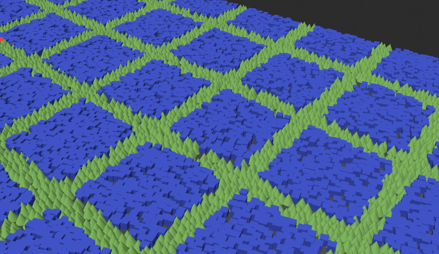

frankmci wrote:
SSmolak wrote:
This is wrong example - you have only one instanced object ( box ). As you see in my previous post I get distribution of box and cone driven by noise in Surface mode.
Distribution of ALL instances driven by noise works fine obviously.
To be clear - there is no way to do this using Poisson :

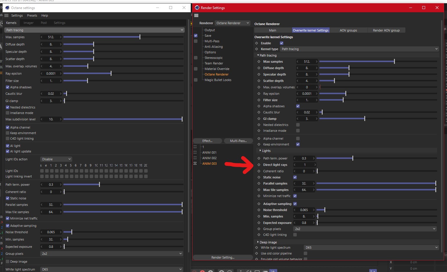

Hi, Aoktar
Plugin is working great!
One question: what is this "Direct Light Rays" slider on Kernel in the Render Settings window? Only shows up under production settings, not on liveview window settings.

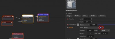

Distort 3D mode doesn't work in baked Layer Shader connected to Octane Scatter distribution :

Kalua wrote:Hi, Aoktar
Regards,
It's a feature/parameter from Octane 2024 version. Looks like I've missed to make it hidden on 2023.
