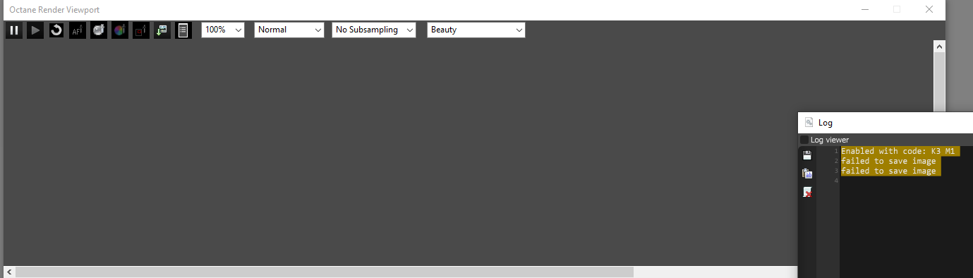

Hi Paul, I open up the plug in and got a blank screen. Had to close poser completely and reopened to fix it.
This is the error code.
Code: Select all
Enabled with code: K3 M1
failed to save image

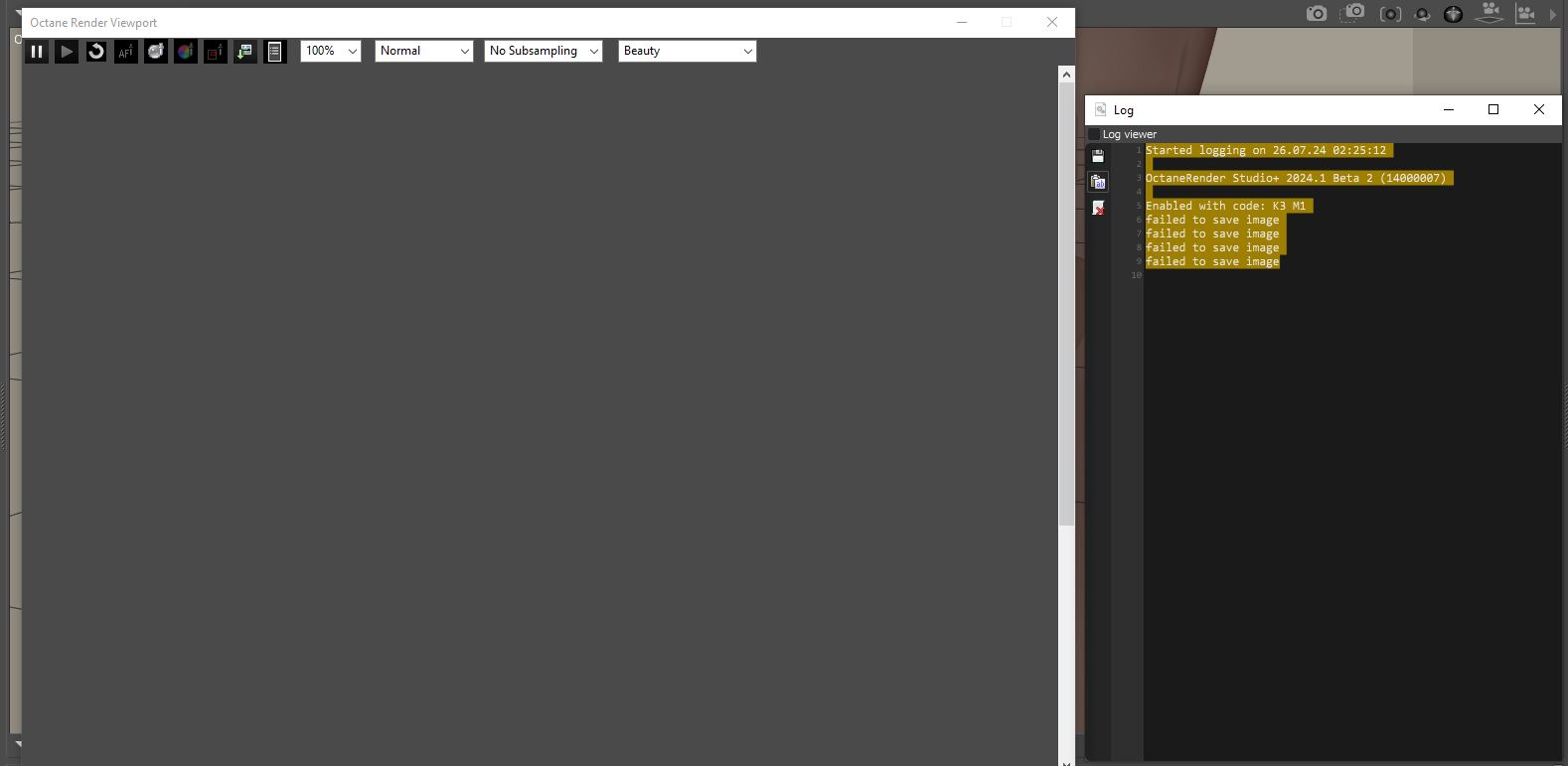

But I get this even when I'm not rendering to image files sometimes. It's random. It happened again this morning. Here's the error code. I'm not rendering to an image just trying to view the scene.
Code: Select all
Started logging on 26.07.24 02:25:12
OctaneRender Studio+ 2024.1 Beta 2 (14000007)
