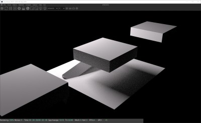

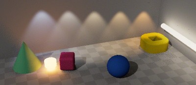

Tim_Twisted wrote:
Tim_Twisted wrote:Hi @aoktar,
Would it be possible to share a scene which shows the difference in speed between primitive & analytic lights? I did a few tests and I don't see any increase in speed (the primitives are actually faster in cleaning the noise) which probably means I'm missing something. Also, is it possible to change the shapes & colours of the lens flare?
Any ETA on this? This is one of the few features I was really excited for in the last few releases, so it's a bummer it is not working (for me at least).
What about ETA? Analytics are very fast a I can see and talk to Standalone topic because it's a CORE related question.

Tim_Twisted
Posts: 53
Joined: Mon Apr 23, 2018 1:31 pm
aoktar wrote: What about ETA? Analytics are very fast a I can see and talk to Standalone topic because it's a CORE related question.
It's not slow or fast, I don't see any difference. So you are confirming this is an error within the standalone, and not something in my scene settings or c4d plugin?
Take a look at Silverwing's latest video:
https://youtu.be/9R6-FTFSo1o?t=75
Raphael breaks down really well: analytic lights are mostly beneficial for direct light, that is, first direct bounce of light.

Tim_Twisted
Posts: 53
Kalua wrote:
This is really a bummer, I was under the impression that the analytical lights were more useful, especially looking at the image with the walls used in the release topic, and more importantly, since it's mentioned nowhere that it is only the first bounce which is resolved faster (which Octane didn't really have a problem with to begin with).
