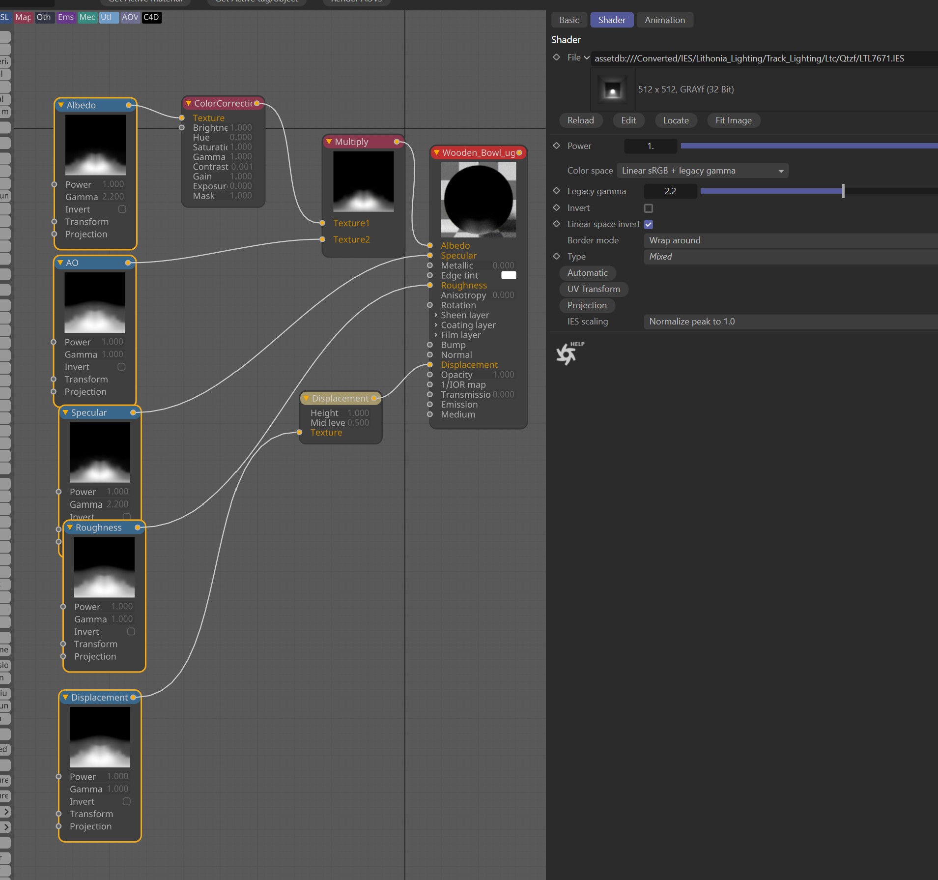

After installation, project material textures (all of them) are changed with an ies file (I using it for a light in the project and ies files comes from C4D library)
I saw a comment about this, I just wanted to share a screenshot maybe it can help.
Edit: I'm preparing an optimized file and share with you.

I've done some test about this problem and I tried to "Save project with asset" thing.
After gather all project files in one folder, project was opened correctly.
Note:
All material texture files in the project come from the asset library and from another disk. Nothing from the project folder (tex folder) is used.
