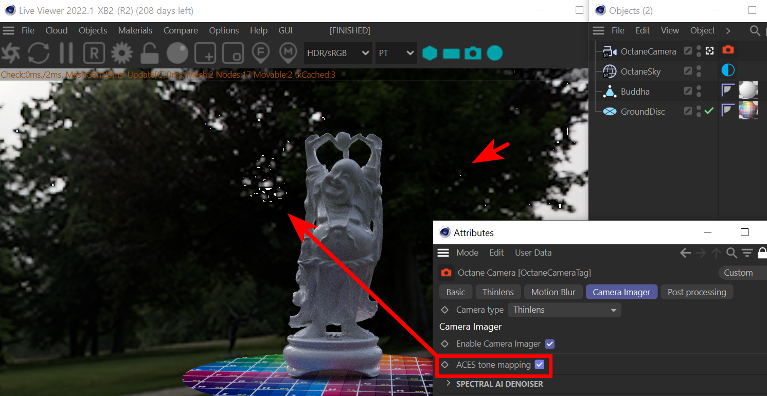

eyeonestudio wrote:ACEs Tone Mapping
LV - HDRI Environment - Visible Editor, Renderer Off - It turns white.
LV - HDRI Environment - Clipping Dark Area
Please put some example scenes.
tonemap.zip
(14.16 MiB) Downloaded 257 times

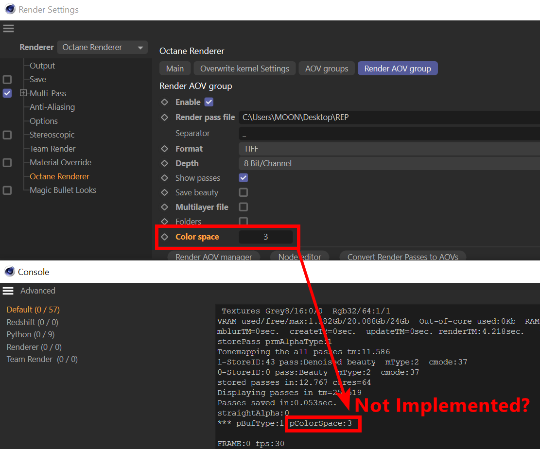

Render AOV > Color Space
Couldn't find it in the update description.
What is the function?(pColorSpace) Not implemented yet?
C4D R2026 / Win11 / AMD TR WX Series / 256Gb RAM / RTX 5090 FE / 100GbE

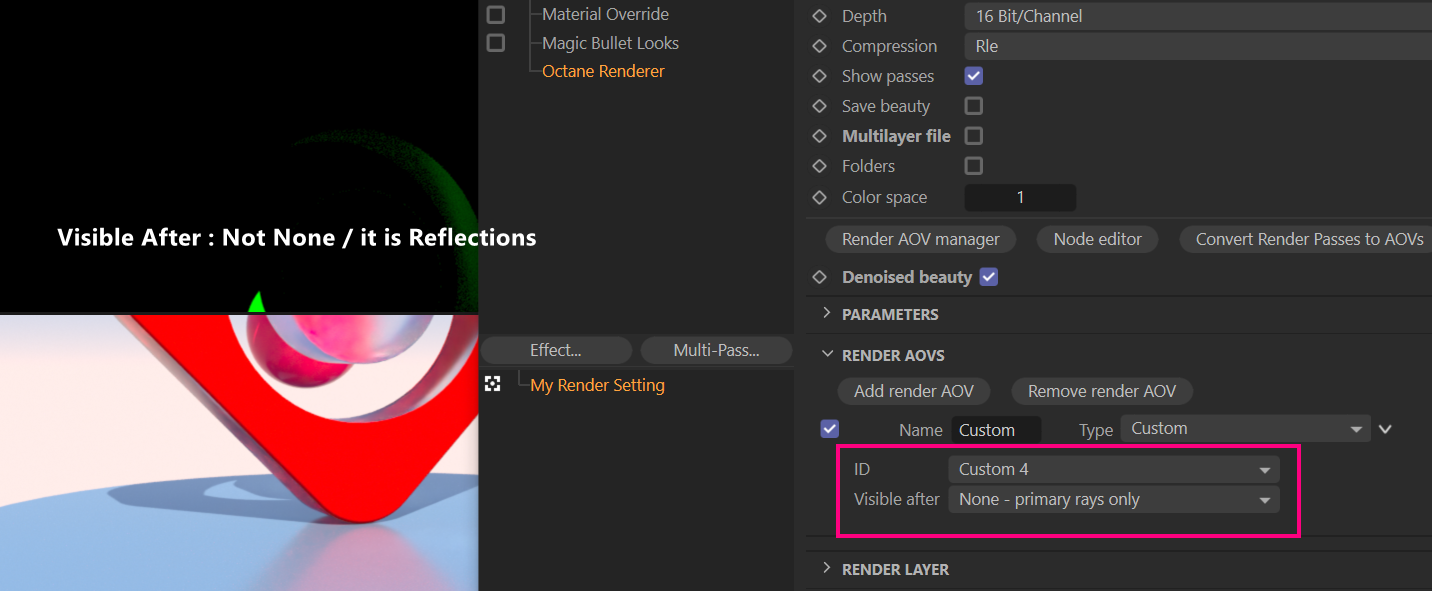

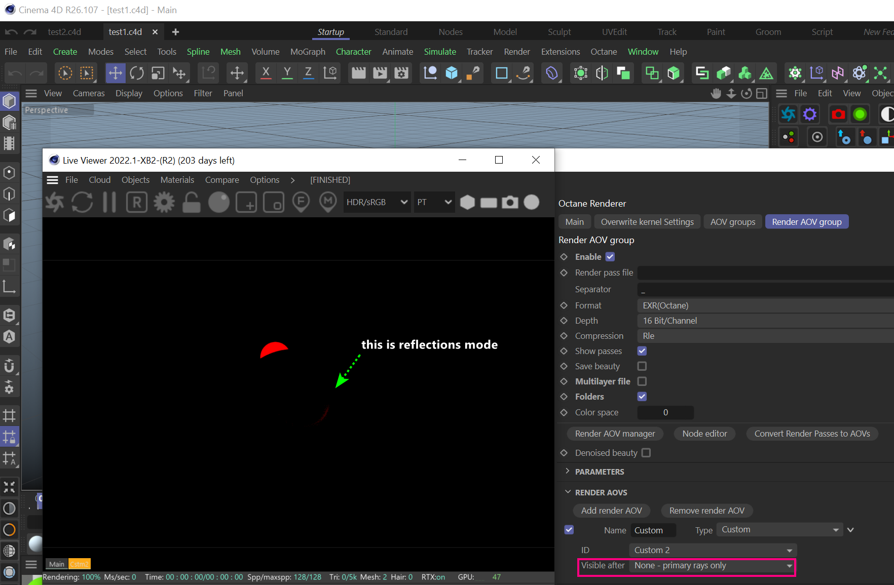

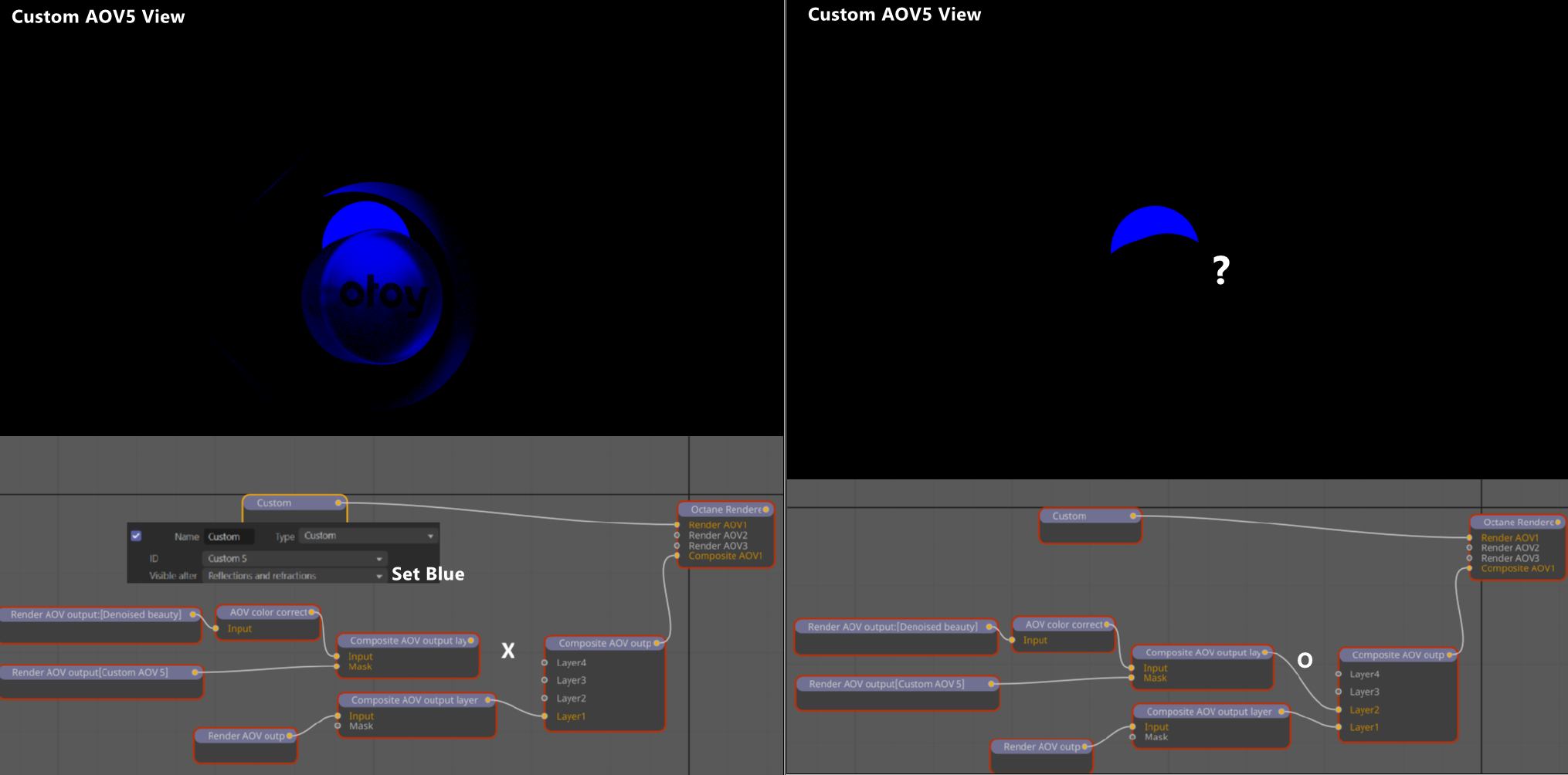

"Visible After" behaves badly the first time it renders.
After changing the options a few times, it works fine.
When Custom AOV(Reflection & Refractions) is connected to Composite AOV, it is changed to "None" type.
I tested a few releases. (R19, S26 Test Only)
2021.1.0.R7 - OK
2021.1.1 - OK
2021.1.1.R2 - Not
2021.1.3 - Not
2021.1.4.R4 - Not
2021.1.5.R4 - Not
2022.1.XB2.R2 - Not
