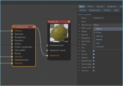

SSmolak wrote:Changing Layered Material type to different one like Diffuse doesn't work. Only way is to create new material from scratch.
Not sure what are you showing and how you can see this menu command. It's not appearing on sub materials. And deleting/creating is not only way to change the type. See pic.
I mean Octane Composite. I thought that this menu is to convert it to something else ( not layered one ). I have old material with which is layered that now can be done using Octane UIniversal but I see that there is no way to simple convert or change it to Universal one.
Why don't you just use the "material type" for that?

aoktar wrote: Why don't you just use the "material type" for that?
even if I change it here for sub-material it still be layered one :
I can change only sub not main.

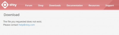

I can't download Enterprise R3... am I missing something?
C4D 2025.3.3 Octane v1.9.4 // Octane SA 2026.4, Windows 11 Pro, X399, AMD TR 2950X, <<2 X 3090 + NVlink>>, 128 GB RAM, Corsair 1500i - NVIDIA SD 610.62
Octane User since V1 Beta
Posts: 16068
Location: Türkiye
Kalua wrote:I can't download Enterprise R3... am I missing something?
File was deleted by mistake, replaced it again. Sorry for that!
