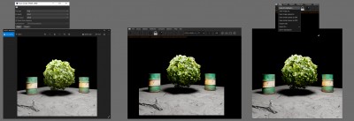

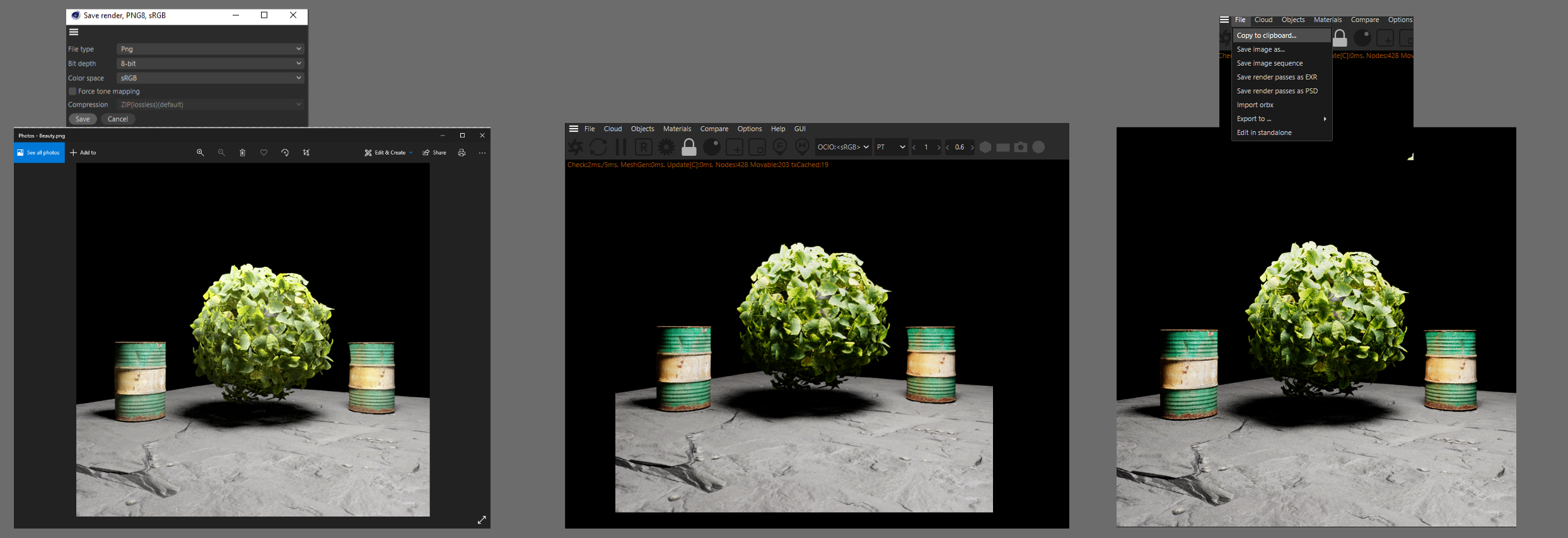

Hi really loving the new ACES side of the octane!
I just had 2 small issues with D65 and saving directly out from PV as png.
1)
when it's directly saved as PNG.
the white balance doesn't match with D65, but it matches with legacy/flat
( seem like it's missing a D65 transform when save from PV to PNG)
When save as directly out as EXR, every colour looks right as I set it as ACEScg.
2)
I have denoiser turned on.
but non of my multipass exr pass has Denoise applied, at least the beauty pass isn't. Would be great to find a solution for this first.
Cheers

Not sure what you mean to first, if you're saving as PNG/EXR in LV then plugin will use Octane's saving functions. I cannot see any problem on saving. Maybe worth to illustrate it a bit better.
About second, you cannot get denoised results in to beauty if you're using Octane-EXR. Because it's directly saved from Octane render buffers. With other formats we can do that because there's a transfer buffer(copy denoised to beauty) to revise.

Awesome Wehn and where we should use octane-EXR?
1)
this is what I mean in the first part
Posts: 16068
Location: Türkiye
Rifat, you have to use it in Picture Viewer with render passes.
