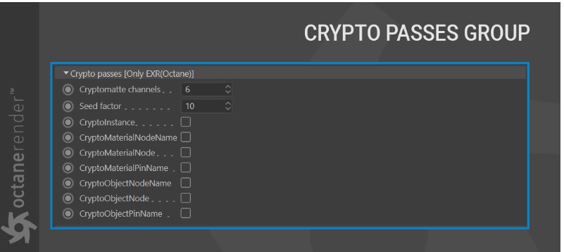

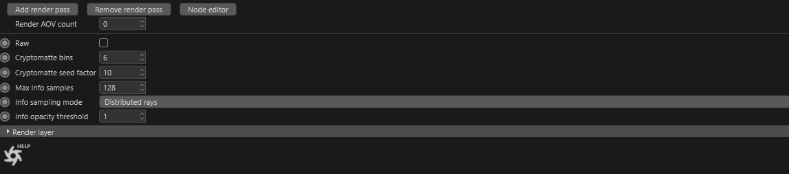

On my computer, the choices for which Crytomattes to use is missing with 2021.1 RC1 and RC3 plug.
What I used to get. Did something change?
jayroth2020
Posts: 495
Joined: Mon May 04, 2020 7:30 pm
Yes, there are differences between the 2021.1 builds and the previous 2020.x builds. The 2021.1+ builds expand the AOV system significantly, and there are numerous UI changes.

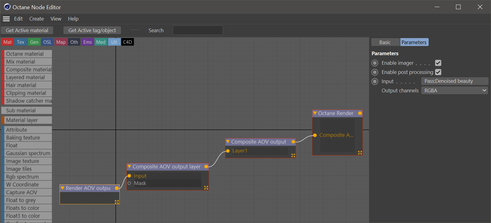

**So where is "Denoised Beauty" in the AOV choices?
jayroth2020
Posts: 495
To get a Denoised Beauty AOV, create a Render AOV output node, which connects to a Composite AOV output layer node, which connects to a Composite AOV Output node, that is connected to the Octane Render node. Select the Render AOV Output node, and set the Input drop-down to Pass:Denoised Beauty.

Thank you, Jay. That's a huge help. I appreciate all of your time.
**Found I get the denoised pass in my .exr if I check "save beauty" in The Octane render pass tabs and I dont check it under the main render tab.
