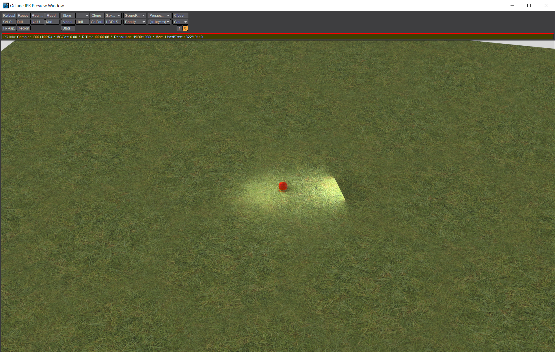

promity wrote:It seems to me that this only works with objects that have UV.
Ok - I've go and give the plane a UV map and see if it makes any difference.
Thanks.
wavesoflight
Posts: 14
Joined: Wed Feb 14, 2018 2:32 pm
Yep - it only works on objects that have a UV map. Cheers for the assistance.
